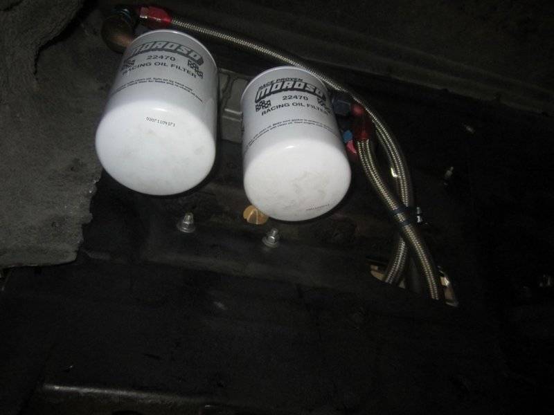

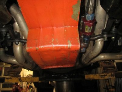

hemi-itus...what were those 1 way valves u had on your milodon pan that u were selling?u told me what they were but that info was lost :(...
They are called pre filters.They had a screen in the canister to catch debris before getting to the oil pump.They also unscrewed for inspection.

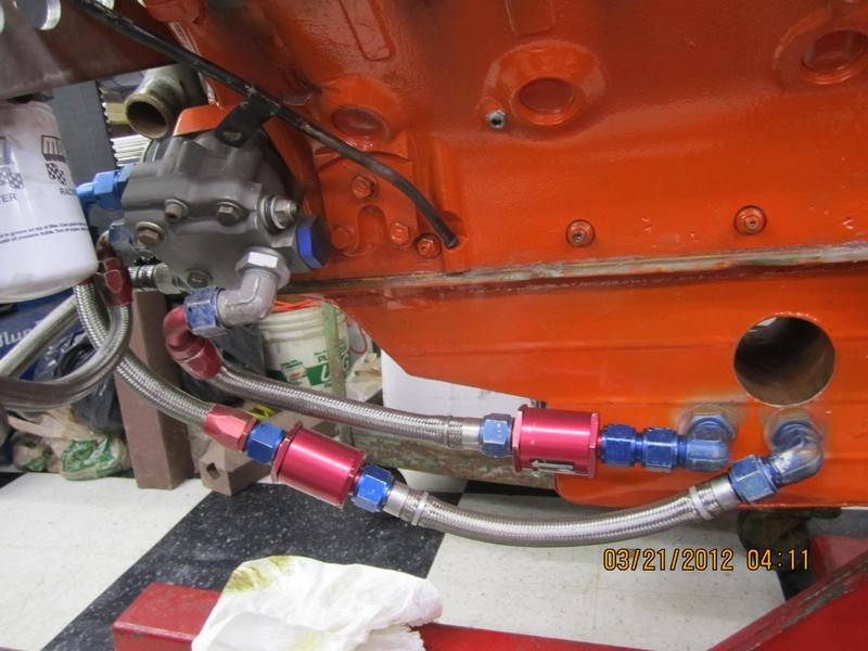

3.21.12 (10).jpg 3.21.12 (12).jpg 3.28.13 033.jpg 3.29.13 012.jpg 5.31.15 015.jpg 7.8.15 023.jpg 7.12.12 (2).jpg 7.12.12.jpg ear-230312erl_w.jpg
I have never in my 45 years as a MOPAR guy ever see that used in the pick up lines from the pan. Then you might need 2 if you go down that road.

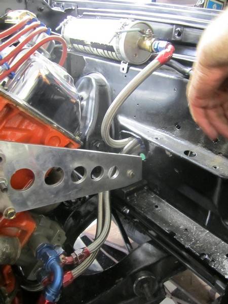

so..the valve at the bottom releases the oil for pre-lube,,but after sitting for weeks/months/whatever,1 must pressurize the tank with compressed air for it to work?unless by some miracle it maintains the 60 psi or so of oil pressure upon shut down?which is fine,just trying to under stand the method..looks like I could mount a 16" x 4 1/2" in front of radiator on the trans cooler mounts horizontally.from there its easy plumbing..
