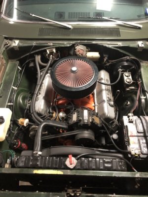

my 68 sat 440 has an eddy performer RPM intake and street avenger 750 carb, 4” tall airfilter on a 1.5” drop base. K&N aircleaner filter+cover adds another 1.5” in height. Total height from bottom lip of the valve cover is about 11.5”.
At present, I have a liftoff fiberglass a12 hood, and the aircleaner definitely protrudes up into the scoop.
We’d like to stick a factory side-vented GTX style hood on there. I don’t have one yet, or I’d just throw it on and find out:
Can anyone confirm whether I’ll need to change anything to fit under that hood?

Here is what I think you'll need: More drop on your air cleaner base, and a shorter filter.
How you measure the "drop" will matter. Is yours truly 1.5 from the carb mounting surface?
Going from memory, I think my drop is close to 1.75" and I run a 3.25" filter element, and I have some witness marks where stuff touches.

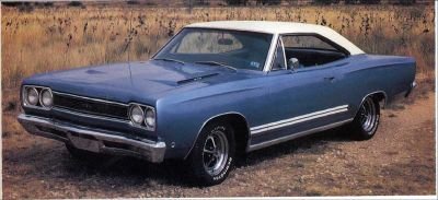

Is this the hood you are referring to? Because its the one we want to fit.

can you post a couple pictures of your setup/hood?
I have that hood/car (1968 GTX) with a 440. I'm running a factory intake, an Edelbrock AVS (same thing as the original Carter
basically) with a 1" spacer and the factory unsilenced air cleaner. Clearance is not an issue. but there's not much more wiggle
room either.

whatever you use, get some modeling clay and place it on the highest part of the air cleaner and the lowest part of the hood and GENTLY close hood and measure the clay for clearance. if you feel it to be too tight then go with a good quality torque strap or change to poly motor mounts.
On my 68 satellite with the factory hood, 440, Torker 2, Holley carb, 1/2” spacer, moroso drop base air filter with 3” element.
3/8” between the wingnut and the hood.
The RPM is shown as having a carb pad that’s .680 higher than the Torker 2.
So on my car, swapping to the RPM would have required getting rid of the 1/2” spacer, and I would have then had about 1/4” between the wingnut and the hood.
The Holley SD manifold is noticeably lower and provides for more spacer/filter options with the stock hood.

Thanks! That’s all with the flat factory satellite hood, like the hood in this picture?
