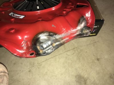

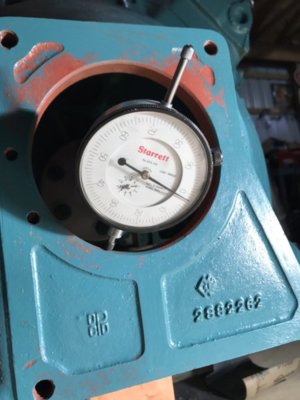

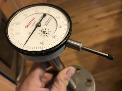

I used a McLeod in my 440/18 spline, 11” application.
I used the “pro” disc (dual friction type similar to centerforce) it was for applications up to around 550 HP, if I remember correctly.
It’s a diaphragm pressure plate design.
I used the robbmc dowels. Don’t hammer a .500 ford dowel in the block as you risk cracking the block. Not a good thing.
You really need a dial indicator and fixture to check runout.
I used a hays SFI flywheel asbit was only 200 bucks and I like my feet.
Final thought:
Take the time and spend the 100 bucks or so and have the flywheel and pressure plate balanced. Assuming they are neutral can be an gamble.
My flywheel was off a bit and the “neural balanced” McLeod pressure plate was WAY off!
6D87A451-3437-4E97-902A-9AF550333298.jpeg C09C34C7-DB90-46C9-AB8A-B8C01705AE7C.jpeg 65FB6349-F574-49D4-8B47-9C9B2C22DB5A.jpeg
I used a hays SFI flywheel as it was only 200 bucks and I like my feet.
Final thought:
View attachment 738122 View attachment 738123 View attachment 738124
