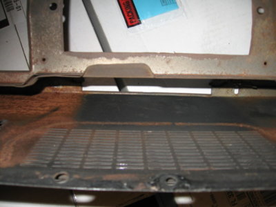

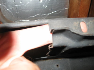

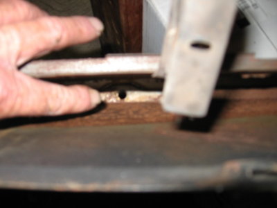

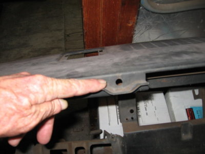

If your not taking the dash out, here how I got the dash pad out. The cluster,heater controls,glovebox have to come out. I never lowered the steering column. Here are some pics of where some of the holes are. There are 3/8 speed nuts.
The next hole form the one near heater controls should be 10 inches and the next 7 1/2. This is the same both way's. Man what a pain in the butt. Then I got to put it back in !!!!!
