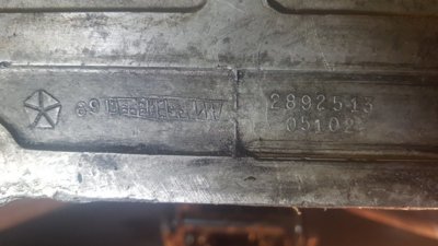

Probably a dumb question but i am going to ask anyways, I am going to try and install new clutch(first time) with the trans dropped and i removed a cover from the bottom, can i put the new clutch in without removing the bell housing or is this going to create alot of problems?,I would like to not remove starter as it jammed in by the headers and looks like a pain in the ###. Car was a 383 manual car and now has a 440=6, I am not sure if this original bell housing or not, please let me know if you can. the last pic is of bell housingnumbers Thank you in advance for any help.

Hi Fran, no I havn't, not sure if i have to remove the bellhousing first or can i remove the clutch with it in, looks like i have room but never having done one not sure how much room i need, btw do i measure the fly flywheel when i order the clutch or do i measure the clutch plate ? Do i have to resurface the fly wheel ? i dont think the rivets hit it dont see metal just trans fluid everywhere sorry I just shecked the link another member sent me, it says i have a 10.5 bell so i assume i order that one ?
I know i am asking a lot of question, but i have found out info quickly thanks to the Link sent by NJJR (Thanks) So It says I have a 130 tooth flywheel and a 10.5" bell housing so I am assuming i Buy that size clutch, What has me confused is i read it has a 10.95 " mating surface(fly wheel) not sure if i have to buy a 10.95 clutch.So do /should machine fly wheel or can i just clean it.I guess I am in panic mode this went from a $6.00 dollar input shaft seal to wow i am afraid to guess (wife is going to freak)

That housing will work for the 10.5" or the 10.95" along with the 130 tooth flywheel. Make sure the pressure plate and bolts for it will accept the 10.95" disc if that is what you buy.
