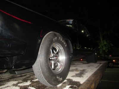

I use the ET Sreet R's for mt street tire and an ET/drag 10.5W at the track. In the street I can easily blow the tires off unless I roll into WOT in 2nd and it normally stay stuck. I di use them at the track a few times but it's faster with the small tire:thumbsup:

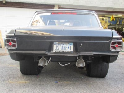

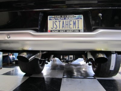

I love BIG FATTIES in the fenderwells...
But BIG FATTIES under a B-Body CAN'T BE BEAT!
:lowdown::moparsmiley:
