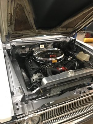

Have and still do. Bought it that way about a yr ago. Block was windowed. No problems so far with block. Has a big oil cooler which from what I’ve read is important. Running a Mancini monster radiator. T stat is a 160. And a big 7 blade fan with short clutch. Motor put out about 500 on dyno so it’s not super built. Thinking exhaust valve guides and seals are shot though as it smokes over 3000 rpm bursts or long trips on the highway. Mines more for a driver. New blocks aren’t that much if your really worried about it. Stuff isn’t cheap. If u have no other parts besides block I’d consider a crate. But to answer your question will be fine with block filled and not overheating.

Sitting in traffic then overheat alley at the Syracuse nats it never went over 200. Stop and go for prob half hr. Was close to 90 later in the day with lots of humidity. Block will be fine. Mines std bore. Normal driving btwn 170-190. Is it just the block your buying?
