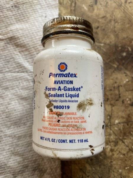

Does anyone know which exhaust studs on 906 heads have water jackets behind them? Haven’t ran in a while but did have some wet studs in the past and want to properly seal this time! Thanks
Most, if not all. Just depends on the casting to which ones did or didn't punch through.
Thanks for the info. Studs removed for sealing. This is what I plan to use to seal the stud threads.
