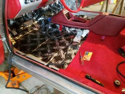

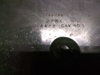

Here's the part number on the bottom side. It looks correct for a 69 B body.

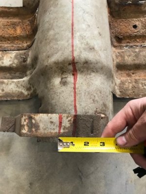

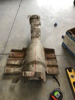

Your console is in the correct position. Attached are pictures of a floor section I pulled from a 69 sport satellite. I marked a line down the center, and then another line at the center of the rear bracket. It is off by 1 inch. If you attempt to move it, you will run into interference with the passenger seat.
Another point of reference is to look at the seat bracket holes in the first picture above. The drivers side is at least 1 inch farther from the centerline than the passenger side. It's all because Ma Mopar set the drivetrain off to the passenger side.
