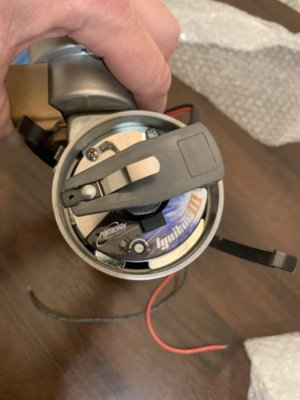

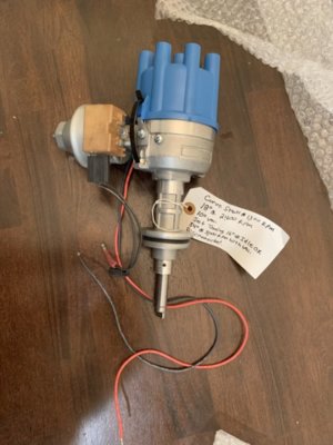

Yeah, talked to him yesterday and he suggested I send him pictures of my distributor. In our conversation he thinks I don’t need an ignition setup. Awaiting his reply. The world needs more like him!

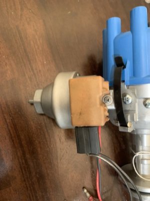

Looking at my pictures, do you guys think I still need an ignition box from anywhere?

juts feed with 12 volts the red wire, while black to - lead of coil. Need to Jump out or bypass ( or modify ) the resistor thought.
whats the tanish plastic box attached ?

DUDE!! You have an :lowdown:Ignitor III module in that distributor! :bananadance::thumbsup:

Maybe I missed the intent of your posts?
Those are AWESOME!
When I had the 421 Tripower rebuilt for our 65 GTO, I chose the Pertronix billet aluminum distributor with the Ignitor III built in!
I've considered doing that for my 440 in the future!
I'm learning as I move along, and in this case, I have an awesome wife who wanted to get me an awesome Christmas gift. I had my distributor rebuilt a while ago with Ignition Engineering in Anaheim, CA. I got it back and it went into it's project build box. Stupid me never looked under the cap.... well, now I get some needed brake conversion parts!!! Merry Christmas! My upcoming birthday coming is also going to be Mopar parts, WW2 planes and cars!

Having a 71 which didn't get ECU box, the ignitor III module into the dist could be the best hidden upgrade. No need for extra wiring harness unless was already made/added in the past for some ECU upgrade. You can hook up the red wire from + lead of coil once ballast is worked ( eliminated, bypassed/jumped or modified ), and black to - lead of coil.
My vote is for a modified Ballast on back and keep the ceramic piece on firewall still hooked up to keep the stock look.
