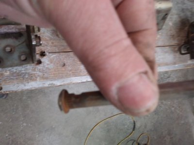

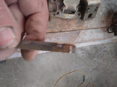

The door hinges. The left has a missing wavy spacer in one of the little gear wheels. The wheel wobbles around. The pin is worn top and bottom. As are the holes. The section with the plate across it is bent.The right side is in much better shape with only a tiny bit of wiggle.

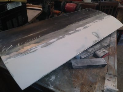

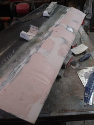

The bottom section of the door is in the second coat of filler after having been sprayed with guide coat twice.
