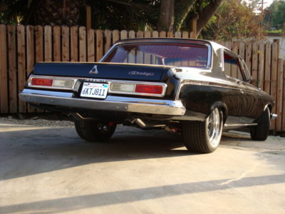

There is a 62 dart here in socal that runs a 10.5x33 out of Bob Moshers shop, but I don't know what was done to get them under there. I know it was something , because those tires are Huge! I can barely get 10.5x28 under my 62 Savoy (more restrictive wheelwell shape than a 62 dodge) and I had to move the rear end back an inch to get them in.

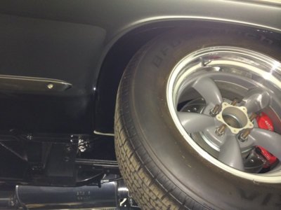

There is absolutely no way this red 65 Bel I is running a stock width axle housing with that much front spacing. That's at least 4.5" maybe 5" of front spacing. Looks great, though! Trouble also with backing plate interference with stock spring location so leaf springs might be moved inboard if running drum brakes. Might get away with no spring relocation if running disc brakes.
Also, that rim is a D-spoke wheel. AR made those so Corvette owners would stop whining about not being able to race torq thrusts on their new disc-brake equipped Corvettes. Thanks, GM. Anyway, Mopar disc brakes never interfered with the straight spoke wheels and still don't. I've got two sets of 2-pc D-spoke wheels on two of my cars so I'm....guilty.
Now narrowed rear or moved springs. I had crawled under and looked. Thought I had a pic but don't. Those buns fit a stock tub no problem and clear the springs. Here's a shot of similar on a '69 RR

Curious as to which rear disc brakes everyone is running? I ordered some from Speedway and aside from wanting to run my head through a brick wall during installation, the rims wouldn’t fit... I sent them back with great angst and disgust.
I ordered the US Car Tool replicator kit. I couldn’t help myself. I installed a set on my 64 Wagon and loved them. I’ll pay someone to do the wheel tubs, I’m not doing that again.

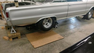

If you have the wheels and tires I you mock it up to see if you have any clearance issue now that way you can decide if you want that big of a tire on their.. not apples to apples but on my 67 Plymouth I can get a 29/10.5w tire on it now using a 12in wide wheel but section width across is 14''' something

I crawled under Bob Moshers 62 dart drag car at the Grand National Roadster show yesterday, to see what I could about how he got his tires under it. It has 10.5Wx33, 11.25 tread. It had springs moved under the frame rails, unknown tubs, looked like widened steel rims on a stock width dana. (It might have been narrowed a little.) Bob specializes in max wedge and race hemi recreations, out of Monrovia ca. I'd walk in his store and ask, he's local, but maybe he will answer his phone. I won't post it , but I'll bet you can find it.
Edit: I wouldn't be surprised if the axle got moved back some, I would guess at least an inch, maybe more.
