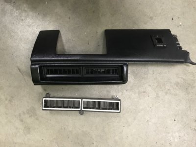

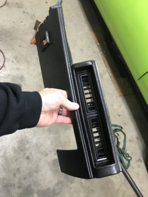

Classic Auto Air has the center vent setup for those that can accept a non-OEM look. Most people won’t know the difference but it’ll be obvious to the purists. A little time spent with a chrome marker would help disguise it.
173F2EA5-89D9-4653-8DC7-13C8A299D190.jpeg 8D860CA2-D8F6-4ABF-A539-0FD38828F26C.jpeg
