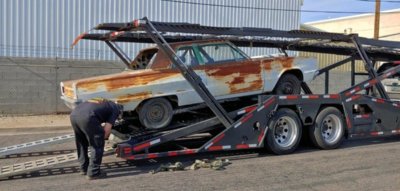

I picked up a CA/AZ 1966 Coronet post car for my next project. This one will be MAXIMVS III. MI and MII are a 1963 Savoy and 1964 Savoy respectively. I sold those (though I might be getting the 63 savoy back some day) years ago and now I'm getting back in the game.
The 66 will be NSS legal and I plan on driving to the meets in this one and hopefully driving back. I pulled the front and rear glass and there is no rust in the channels. The undercarriage including the torsion bar support and frame rails are also rust free - big time dirty though from sitting in the desert for decades.

66dodge89435-1 - Copy.jpg 66dodge89435-2 - Copy.jpg 0107201212a.jpg 0107201214_HDR.jpg 0107201220_HDR.jpg
Started the clean up and inspection today. Here's a link to some before pics: http://photos.emeryengineering.com/FullScreenSlideShow.aspx?gallery=4876927&mt=Photo
Turns out the car has front disc brakes and some weird leaf spring perches/shock mounts I have not seen before - looks to be home made. It also has a K member that I've not been able to identify, if you can take a look and let me know it would be appreciated.
snook
If you look at the pics in the link above, you'll see that they cut out the core support for a larger radiator. I'll be replacing the core support with a 26" unit. I will probably replace the floor with a non-hacked up piece - I don't know if I can live with the stick welded floor that's in there. On the other hand the trunk floor is pristine and will require no work - that's different. It also appears that this was an A/C car - can anyone confirm by the firewall and dash vents?
