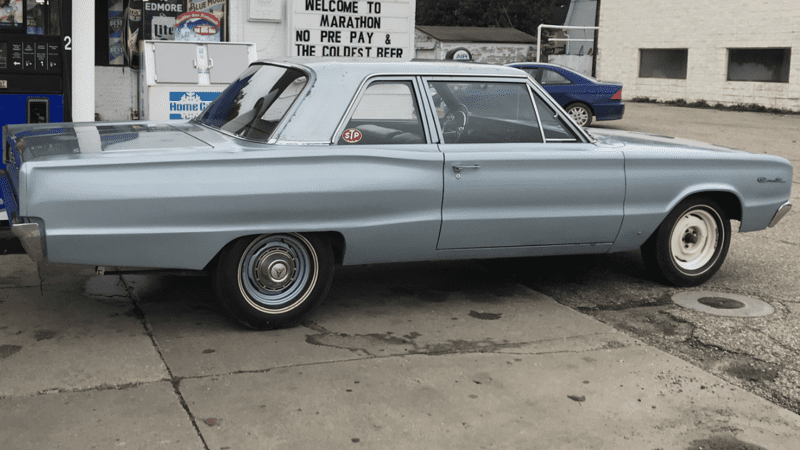

1966 Coronet Post - MAXIMVS III
I got a front glass from Canada last year it's out there not cheap

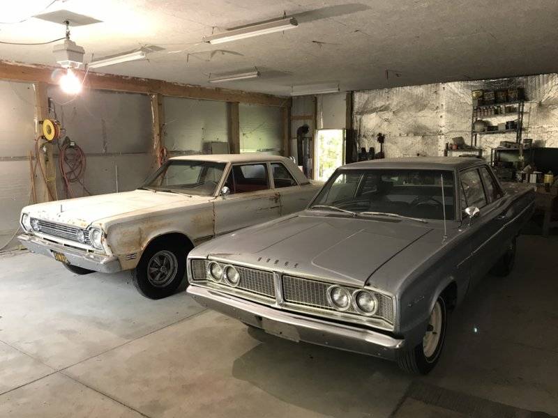

I somehow found two post cars not sure how but I really like them , you don’t see many

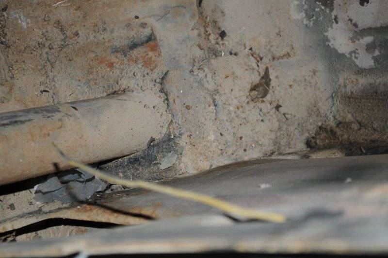

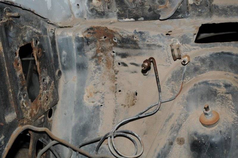

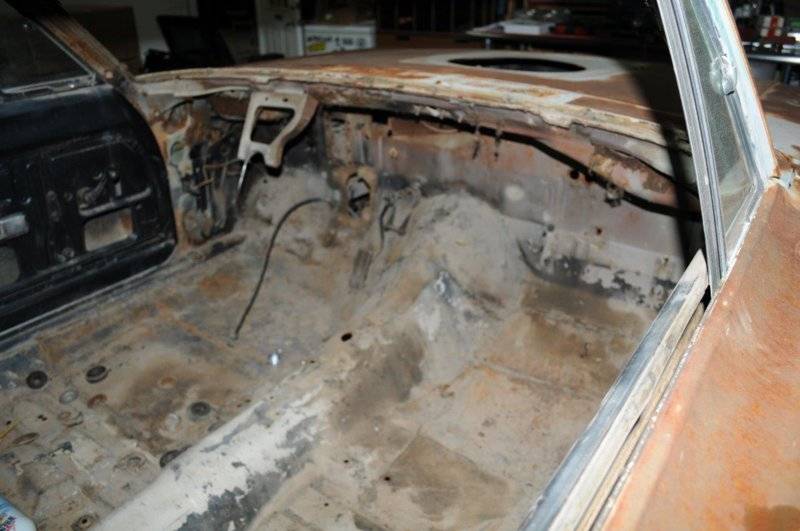

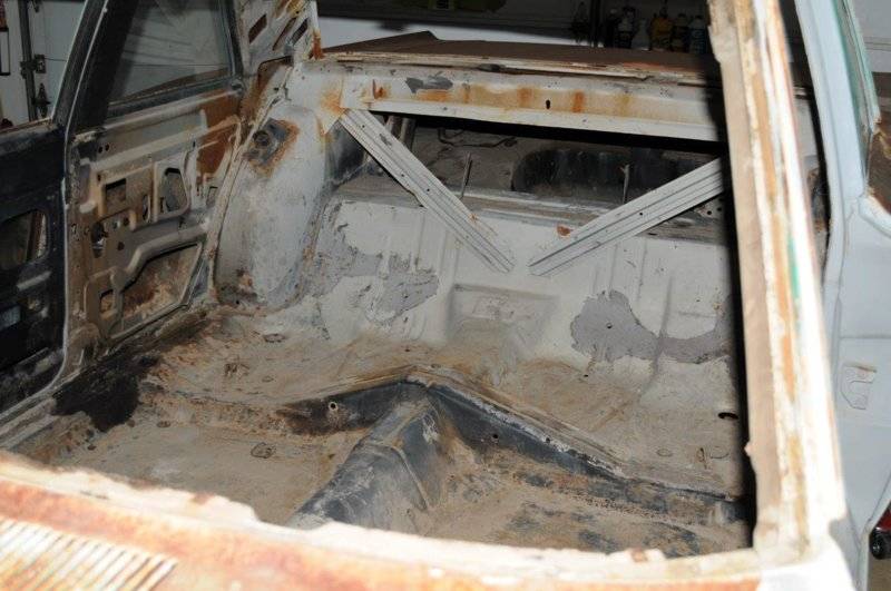

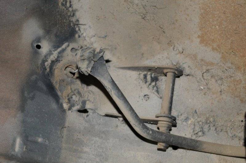

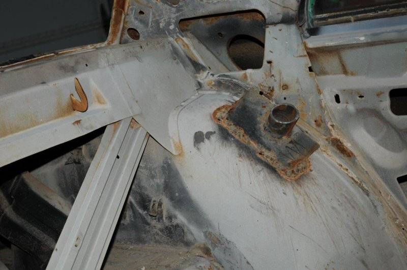

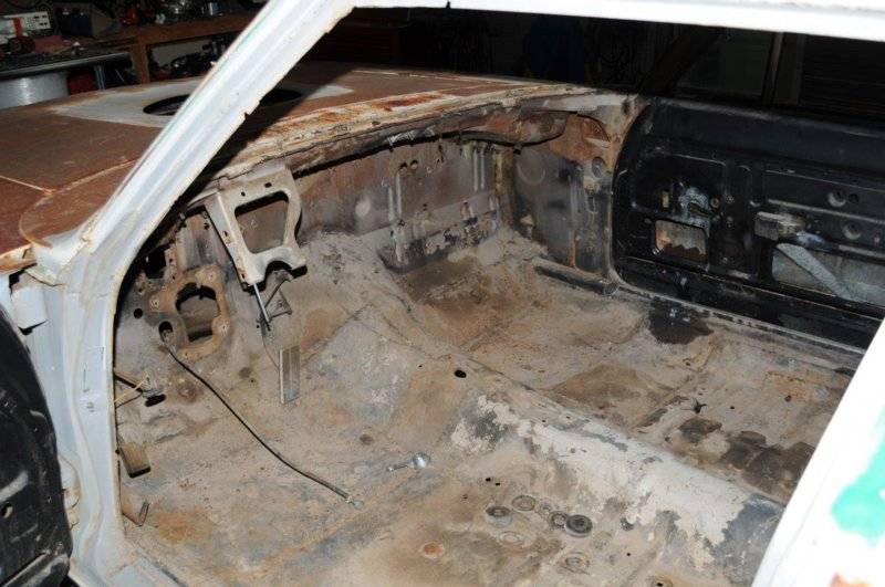

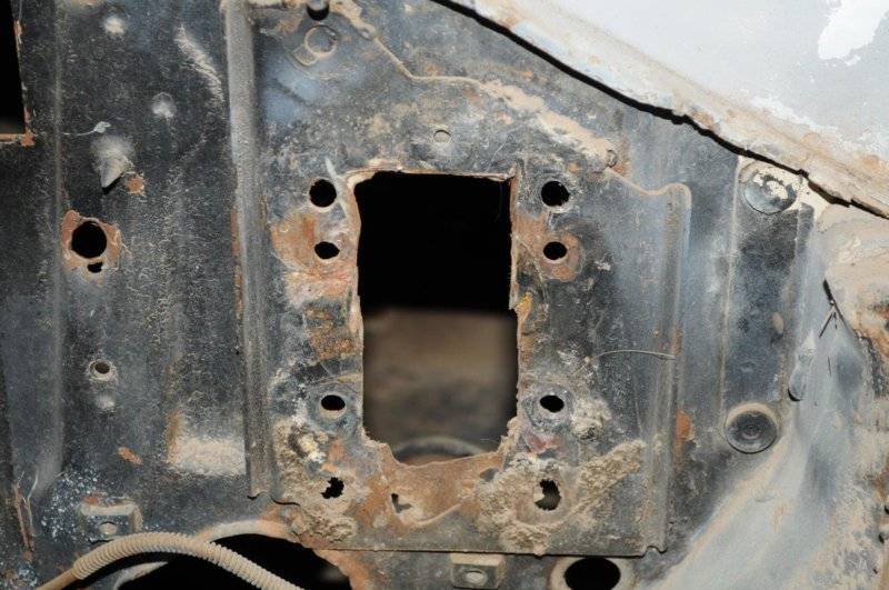

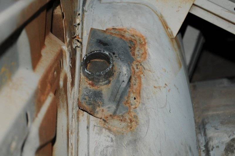

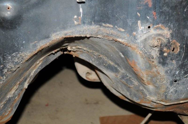

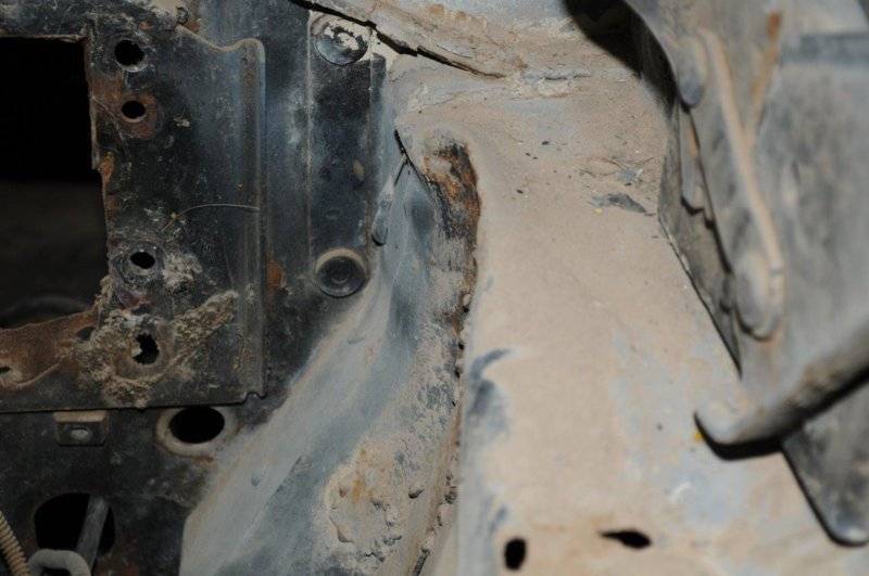

It's ready for the body shop. After I finished tearing it down (and I mean DOWN) it looks like jthe following will have to be replaced thanks to goober:
  • firewall - hacked up the firewall
  • inner fenders - put huge holes in the fender tops and beat the drivers side inner fender to make room for a power brake booster
  • full floor pan - stick welded a patchwork of plates all over the floor, front to back
  • core support - used a sawzall to make a 22" support into a 26" support and did a horrible job of it
These parts are beyond saving. I attached a few pics.
snook

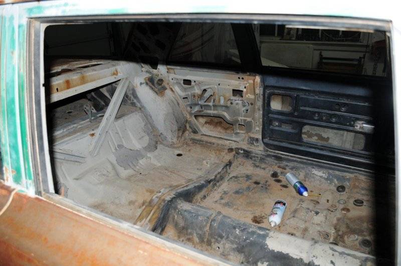

DSC_7882.jpg DSC_7887.jpg DSC_7893.jpg DSC_7895.jpg DSC_7909.jpg DSC_7910.jpg DSC_7916.jpg DSC_7918.jpg

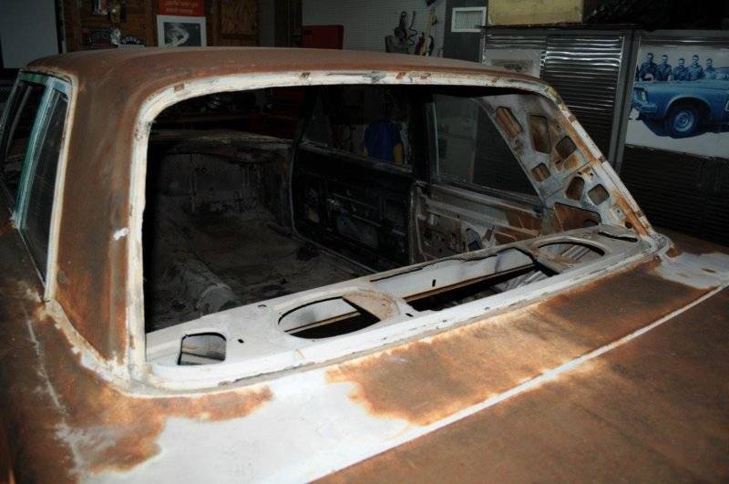

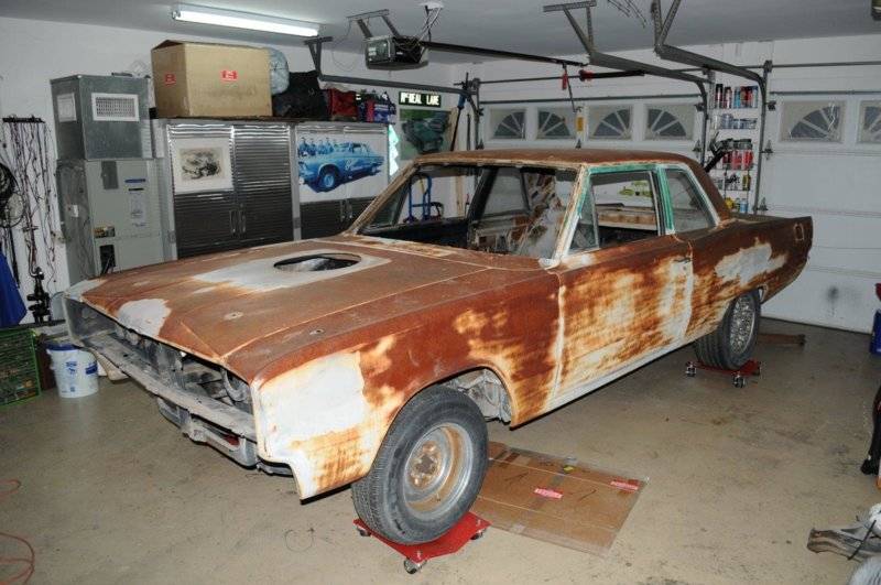

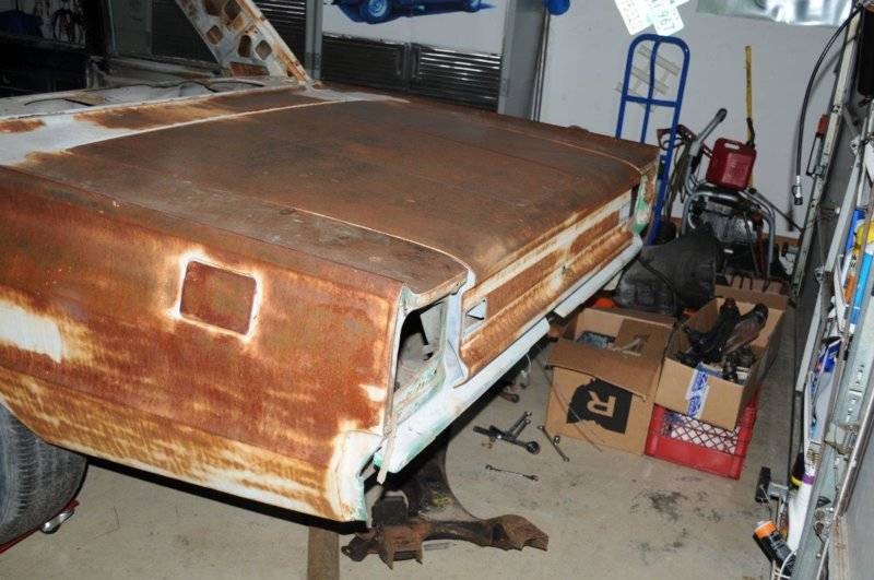

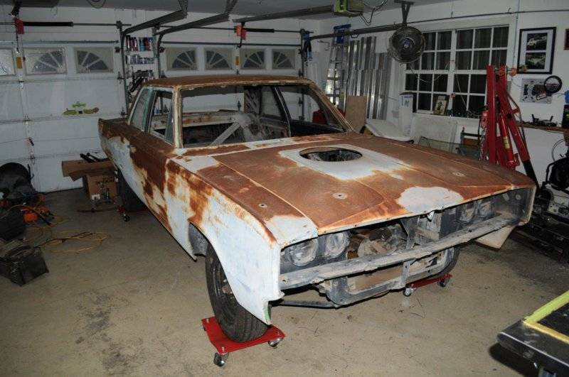

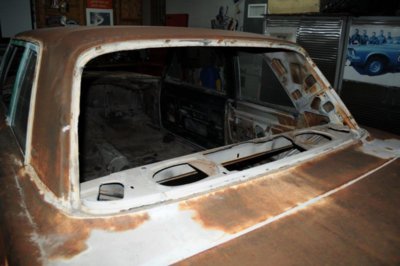

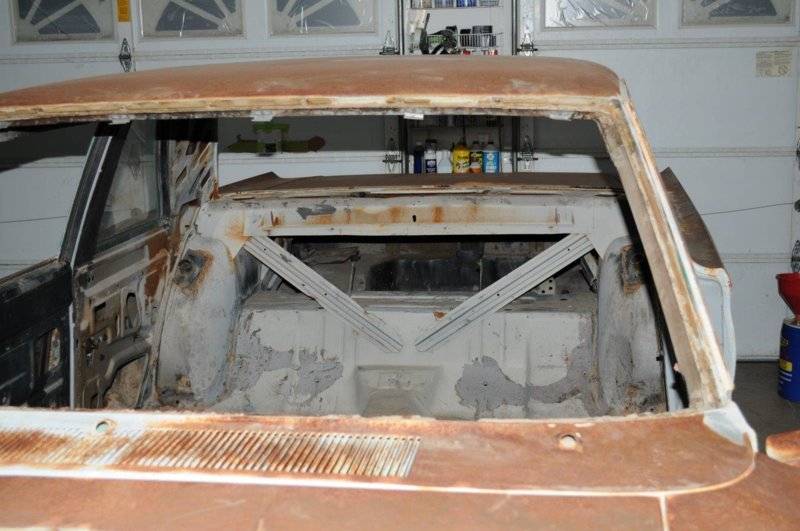

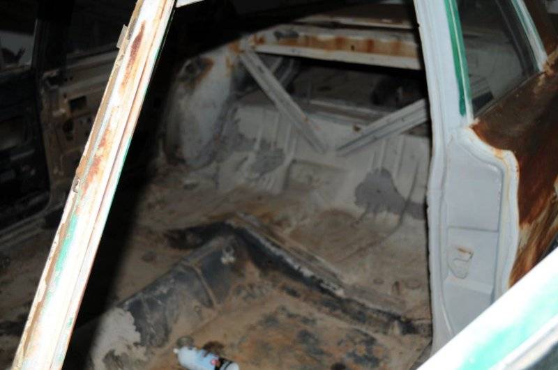

Finished stripping the car and it's ready to go for body/paint. It will be a dark grey primer on the bottom and WW1 white all over. Picked up a nice 26" core support today. Here's some pics of the stripped car...
snook
DSC_7922.jpg DSC_7923.jpg DSC_7924.jpg DSC_7925.jpg DSC_7926.jpg DSC_7927.jpg DSC_7928.jpg

It looks like the engine mounts were moved back towards the firewall. It's an old drag racers trick.
That's the reason there is reinforcement on the engine mounts.
