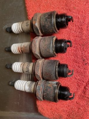

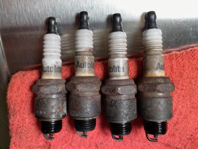

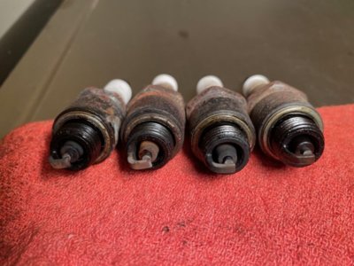

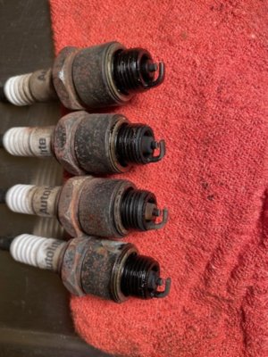

I just pulled 4 of the spark plugs out of the driver side head of my Charger's 383. They look like they are as old as the car!! I read them as saying this engine is running way too rich and is sick! Looks like there is oil on the threads too. They look terrible.. One of them smelled like gas. Only thing maybe good about them is the electrode and ground straps have no wear. Autolite 85 stamped "made in USA" (maybe 49 years ago).
The carb is a Holley 750cfm 4160 dual feed, vacuum secondary, electric choke. Have had this car for 2 months. Carb smells like gas, kinds stinks up the garage if the car has been shut up in there all day. I've been starting it up and running it till warmed up once a week since I've had it. Has only been driven one time, around the block twice with PS pump disconnected, which was about 2 weeks ago.
In mid December, I ended up flooding the engine badly, when I couldn't get the car started (pumping gas and cranking 25 or 30 times). Which was due to an electrical issue, that I fixed that same day. When it did start that day, it ran incredibly rough. Was misfiring due to the flooding. So rough I thought it was going to shake the car apart. Then eventually it smoothed out.
The charging system doesn't currently work in this car and hasn't for a long time. Engine marks its territory on the ground, it leaks oil.. I think the valve covers may be leaking, maybe the rear main crankshaft seal, maybe other places too. But the amount of oil leakage is minor compared to the massive steering box leakage.
Miraculously the engine does not smoke! I never see any smoke coming out of the tail pipes.. From the look of the plugs, you'd think it should be emitting a huge cloud of blue smoke out of the machine gun tips.
The plugs looks like they came out of a junk yard car. These are the most ancient looking plugs I've ever pulled out of an engine. I should have pulled a couple out and looked at them before I bought the car.. Note to self on that.. What do you guys think of these sorry looking plugs pulled from this sick Super Bee?

If the charging system isn't working then you might be getting a weak spark. I would fix that first and then replace the sparks plugs, run the engine and see how they look.
Put new plugs in a stop starting it without driving it. Those plugs under those conditions show nothing but a car run under choke too long. IMHO
If you flooded the engine or run very rick, gas residue and components can coat plug threads with what looks like oil but isn't. But if the engine was really flooded at one time I would sure change the oil to get the contaminated oil out of it. But they are some pretty crusty looking plugs that seem to have been in there a while.
weak spark, shitty carburetor. that thing needs a tune up bad. you need to get 13.8 to 14.2 volts to the battery immediately.
I agree with Frank. Starting once a week and not driving it is really unnecessary and does more harm than good.
If you can drive it till it's good and warm. Cap off the exhaust and the carb opening and work on the other things that need repair.
And change the oil...
Keep us posted and we would like to see the car. Old plugs are just not that interesting.
Just kidding.:thumbsup:
Those plugs are not as old as you are thinking. It's what any parts store is going to sell you in a Autolite plug for that engine. What I do see is gas fouled plugs, that are caused by exactly what you're doing. Cranking and just letting it sit and run until it comes to operating temperature. Most Mopars in factory tune run rich at idle, but yours has a bigger carburetor than stock to add to the problem. The good thing is you said it doesn't smoke. I would fix the charging problem, power steering problem and oil leaks, then give it a good tuneup and most importantly DRIVE the car. Ask me how I know. Try keeping 2 dozen of them running right.

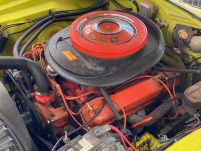

I've attached a few photos of the car, if anyone is curious what those nasty plugs came out of.

I bought the firmest box I could from Firm Feel, made a huge improvement, especially if you’re using a stock steering wheel. It might cost a bit more, but it’s a smart upgrade. Your #2 plug isn’t that bad, but the plugs on the ends definitely show oil being burned, not that unusual. Here’s a pic of plugs from my 408 with just under 1000 miles. If it ran overly rich all plugs would be dark, but those first ones on the left look pretty good. The darker ones were wet, with oil on the threads. Of course fuel distribution probably isn’t perfect with a dual plane
