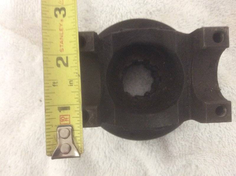

Does your yoke have small tabs (1330) to center u-joint or is it machined for inside snap ring? Pic is of tabs, little hard to see. One with tape measure,
picture is of a 7290 yoke machined inside.

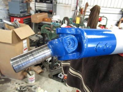

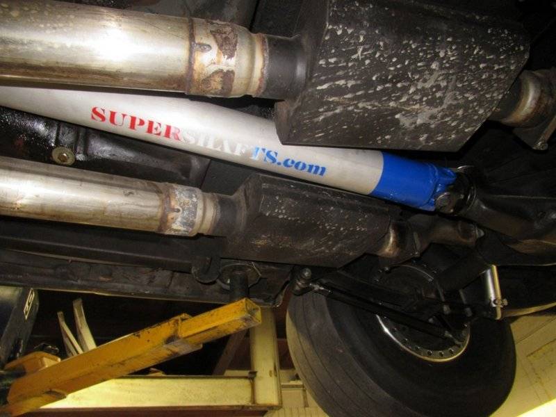

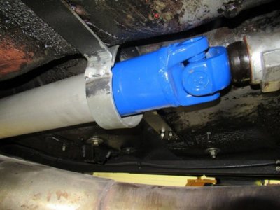

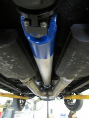

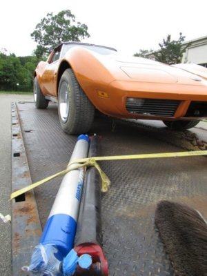

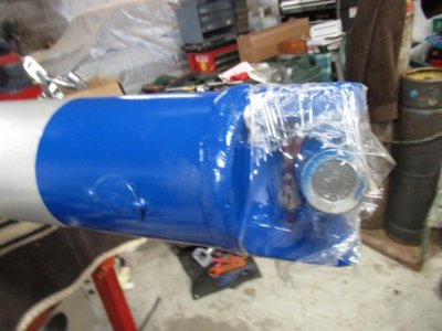

Do the larger joints now front and rear.You can have your shaft modified or buy new CM or aluminum to save some weight.
7.31.17 004.jpg 7.31.17 017.jpg 7.31.17 018.jpg 7.31.17 019.jpg 7.31.17 020.jpg 8.23.17 021.jpg 9.19.17 038.jpg 9.19.17 040.jpg

Maybe that it has a larger u-joint unless a 741 yoke can be put in a 742 case? In post #3 742 caseyoke with tape measure 7290 u-joint 1968? other 742case with yoke with centering tabs 1330 u-joint 1966/67 cars

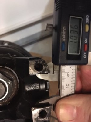

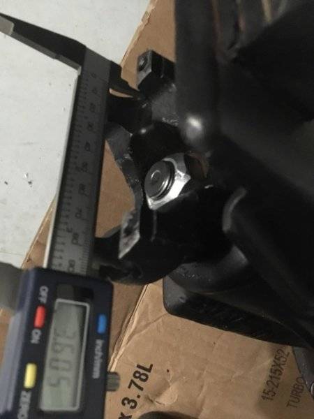

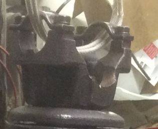

The saga continues...I tried a 347 U-Joint only to find the caps are too large for the pinion yoke although it appears to be close in width. The other side seems to be correct as it fits the spare 741 yoke I have. The local supplier doesn't appear overly familiar with this yoke. The 742 yoke I have has the two "centering" tabs with a distance of 3.60" between them and an approximate opening for the cap of 1.04". Any assistance would be greatly appreciated.

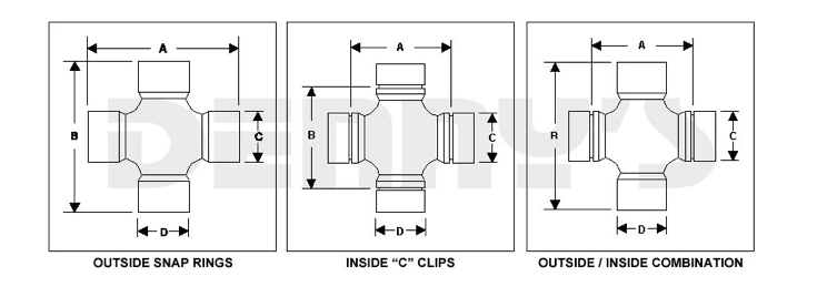

That yoke takes outside clips the tabs are there to center u-joint. The u-joint with clips on cups are for 7260 or 7290 and others. If the tab to tab width of u-joint is 3.625" it takes a 1330 u-joint, cup size on that u-j is 1.0625". Does the driveshaft have outside snap rings? What is the width of u-joint on driveshaft, pictures.
Thanks Fran. Is the yoke OEM? The Parts guy said it was aftermarket because it has the tabs. Not sure about that. I'm not sure about the driveshaft yoke and it's still too cold to be laying underneath to check. I'm guessing it's the same as the spare 741 yoke I have which is OEM. So far my research suggests the Moog 457 may work for this application.

First off, since 741 & 742 cases only use the 10 spline yokes & neither uses a crush sleeve yoke swaps shouldn't be an issue.... Second the standard way the measure joins is from cap to cap since there is significant variation in that dimension where as cap diameter variation is typically less than 1/8"...
Changing from a 741 to a 742 doesn't automatically require a different U joint, there are 741's around with the big yoke... And a few 742's with the small yoke...
