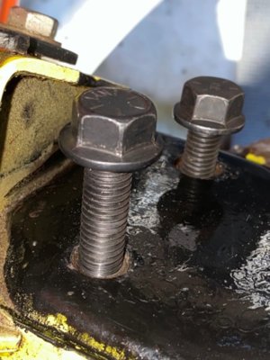

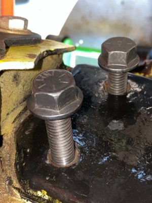

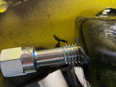

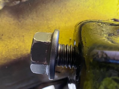

My attempt at mounting the Borgeson box in a 1971 Charger, has ended in failure. I'm not exactly sure what the hell happened during the process. I attribute this disaster fail probably to having attempted to mount the box to the K-Frame by myself, when I don't have the strength of Braun Strowman to hold the damn thing up and get the bolts threaded in place using only 2 hands.. The Scourge China Virus equals no help for the install last weekend.
Three bolts hold the box to the K-Frame. I did a trial run of all three bolts in the holes, before the install attempt. Seemed like all 3 bolts went in their threaded holes in the frame without any excessive resistance. I did the check quick and didn't think too much about it.
I get the box up into place with difficulty.. Then, when facing the mounting surface, I get the upper right bolt started, then the lower right, then the upper left. The upper left and right were a bitch to get started while trying to hold the box in place. After trying to tighten the upper left and right bolts, it was obvious that they both refused to screw in further than 1/4" deep. Bottom right bolt went all the way in till flush with box mounting ear surface. The other two wouldn't budge!

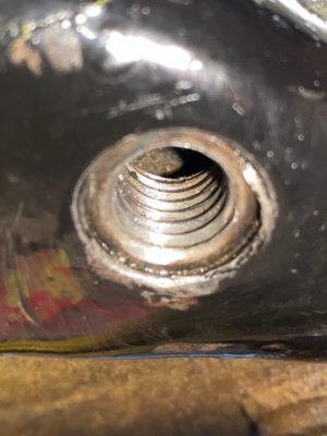

I pulled all of the bolts out and removed the box from the K-Frame. Then spent a good hour testing the bolts on the bare K-Frame. Can't get either of the top two to seat now more than 1/4" deep. The bolts are 1.75" in length. Grade 8 for critical high stress, 1/2" - 13 thread size. I even bought a new set of identical spec bolts to try them. Same problem as the original bolts.
Only explanation I can come up with is that I must have allowed the heavy weight of the box to pull on those two upper bolts or I didn't get them started in the threads with correct alignment. Or the holes in the gearbox mounting ears are not lining up properly with the holes in the K-Frame. So now the bolts will NOT screw into the holes more than about 1/4" deep. So I'm f*^&ed!
I read about Chaser Taps, to chase existing threads to try to clean them up. Maybe try getting a 1/2" - 13 Chaser Tap, and try that. If that doesn't work get a regular Tap and try running that through. Next, maybe a stripped thread kit with the helix insert thing. Beyond that a new K-Frame?? Or just start over with another car that doesn't need its steering box replaced. Getting very discouraged with this car.. Working on it has been like fighting a war. And I'm losing that war..
I've attached photos of the aftermath. I'll post about the 4.5 degree slant on the gearbox tomorrow, as it's late and I'm exhausted..
IMG_1634.jpg IMG_1642.jpg IMG_1644.jpg IMG_1647.jpg IMG_1654.jpg IMG_1656.jpg IMG_1663.jpg IMG_1664.jpg IMG_1665.jpg
well your not screwed may have slightly
crossed threaded them. chase the with a tap

Well it sounds like the bolts keep going in cocked. Look at the bolts - are the threads damaged on those too - if so, clean them up also. In photos 5 and 6 you can see the bolts aren't square to the mounting surface.
After you get the threads ironed out. You can slice the head off one of the extra bolts and start it in the hole It will hold the box up for you.
Yes, buy a set of thread chasers. The set will come with both types to chase female and male threads. The chaser will straighten out the threads. Do the bolts as well. Very useful in working on old cars. I'd shy away from running a tap into the holes. Then, as several members have suggested, cut the heads off 2 longer 1/2" hardware bolts and screw them partially into 2 of the threaded holes. You can slide the box over these and they will position the box and hold the weight for you. Once you get 1 bolt almost home, remove one of the long bolts and install the 2nd bolt, etc. Blue thread locker is a good idea too.

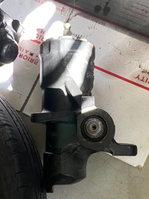

Regarding the 4.5 degree slant of the mounting ears in relation to the input shaft. These photos and the Borgeson plan drawing show what I was talking about in the other thread.
Notice how when mounted to the K-Frame the stock box's input shaft will point directly at the firewall. The input shaft is damn close to perpendicular to the mounting ear surface. The Borgeson box input shaft will point 4.5 degrees toward the inner fender. And it DID on my car when I had it up against the K-Frame. This appears to be by design according to the drawing plan I got off their website. By a design, that probably wasn't meant for our cars is what I suspect. Why would you want the input shaft angled over toward the inner fender? I still need to call them and ask them that.

I understand your confusion, but don't over-think this. The thread chaser will straighten the threads unless you tried huge force trying to install the bolts. Same goes for using the chaser. Some resistance is to be expected but with moderate force, the chaser should work fine. If it locks up or refuses to thread with moderate force then go for a tap. This set will work, no need to buy ARP for a one time use:

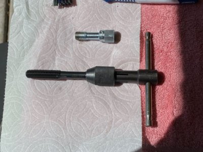

Thanks for your help, along with the other responses from the rest of you guys. I ordered the Summit 900199 set that includes what’s in the set you linked to but has fine thread chasers too, and the matching die chasers. I also ordered the single ARP 1/2”-13 chaser also, as its threaded area is longer in length. I figure one of the two should hopefully fix my problem..
The cleaner/chaser taps arrived on Friday. I put them to use today. The ARP 911-0005 1/2"-13 Cleaning Tap saved the day!!! That thing was worth its weight in gold! I'm glad I decided to order it in addition to the Summit set 900199. I tried the Summit 1/2"-13 first and that was doing nothing. It is too short and wasn't up to the task. My threads were malformed and the ARP straightened them out better than I was expecting. The Summit taps are good for cleaning out dirt and grime from threads, as I cleaned all the exhaust manifold/header threaded bolt holes with them. Now I can screw all my header bolts in and out by hand too. There was a lot of grime inside those threads!
Using the ARP tap I did a little at a time, screwing it in until it hit resistance, then cranked down on it a bit, then screwed the whole tap out. When it came out I cleared the metal debris out of the tap with an old toothbrush, then repeated, over and over. The upper left side thread was tougher to straighten than the upper right, and did require more force. Now I can thread all three bolts ALL the way in, and back out, by hand!
I bought three 1/2"-13 studs at Ace Hardware and have those screwed in by hand. Will be attempting the gearbox mounting tomorrow, this time using the studs.
Found my father's old "made in USA" 1/4" to 1/2" tap driver in one of my tool boxes, so didn't have to buy one. It worked great with the ARP Cleaner tap.

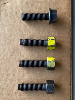

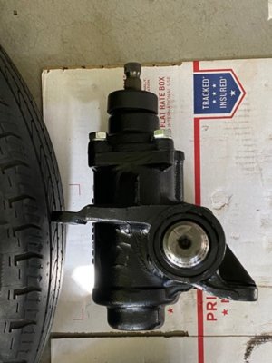

After all that work on Saturday, another fail today, on Sunday... I've had the gearbox up against the K-Frame three times now, and had to pull the SOB back out each time. The second time today, was me testing if it was possible to mount the gearbox FIRST with the header completely out of the car, then put the header up into place after. No f-ing way that was gonna happen, unless maybe the car was on a 4 point lift.
Third time, I got the header between the engine and inner fender, held up and out of the way with rope and a wooden 2x4 up above. This allows the box to just pass through like a baby's head between it's mother's pelvic bones. Both times I could get the box slid over all three studs and resting against the K-Frame, fairly easily..
Problem is the hole in the mounting ear that points toward the driver side wheel. I can remove the studs on the passenger side ear from the two holes on that side, and then carefully turn the bolts in by hand, but that driver side hole, is still a bitch. I could barely get the stud out, then when trying to screw in the 3rd and final bolt, it didn't want to go in and I didn't want to force it. Even if I had someone helping me I still don't think I'd have been able to get that last bolt in..
The holes are 5/8" diameter. The bolts are 1/2"-13. I think the reason I have no problem getting all three holes in the mounting ears over the studs, are because the threaded end of the stud is 1/2"-20 fine thread. The bolts are 1/2"-13 coarse thread. I believe the 13 pitch coarse thread is larger in diameter than the 20 fine thread. So I don't have as much clearance through the holes. The middle part of the stud has NO threads, so when the mounting ears are on that middle part, I can shift the box around, a bit, side to side and up and down. With the damn 1/2"-13 bolts, I can't shift the box horizontally at all, and only slightly vertically.
Maybe the solution is to enlarge that driver side mounting ear hole. Ream it out with either a 5/8" drill bit or a large round metal file, to gain enough clearance so I can screw the damn bolt through it... Or just use the studs and not the bolts at all, and get three 1/2"-20 nuts to screw on them. Though the 20 thread and nuts probably aren't heavy duty enough to hold the box securely in place. When I bought the studs I could not find any that were 1/2"-13 thread on BOTH ends of the stud. One end of the stud is always fine thread.. Un-F-ing believable to have this much trouble mounting a steering gearbox!!!

The OD of the bolts (fine vs. coarse) is the same. Try removing one of your other bolts, loosening the last one, and installing the hard one first, leaving it loose enough to move the box a little for the last bolt.
I would not recommend using studs of an unknown hardness to fasten the box. Have you used a caliper to compare the hole size to the factory box's mounting holes? If you still have problems, try using a rat tail file or a reamer to SLIGHTLY enlarge ONE hole. Hang in there. You'll get it.
BTW, if you slot the end of the stud with a hack saw, you can remove it with a slotted screwdriver easier...
The steering box is held on by a bolts that have shoulders on them so that the 1/2” bolt centers itself up in the 5/8” hole. It also shouldered so that the steering box doesn’t move when it’s under stress.
