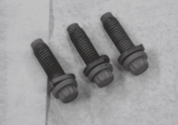

The original steering box mounting bolts on my 69’ bee didn’t have a shoulder at all
The steering box is held on by a bolts that have shoulders on them so that the 1/2” bolt centers itself up in the 5/8” hole. It also shouldered so that the steering box doesn’t move when it’s under stress.
I don't recall ever seeing any shoulders on any Mopar steering box boxes....
Also if you look closely the first couple of threads on the bolts are thread cutters or chasers

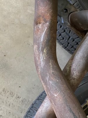

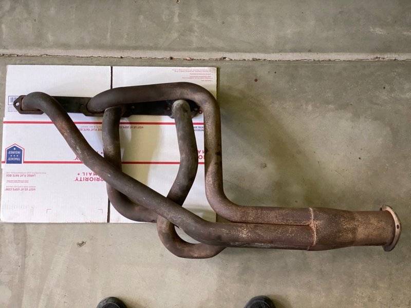

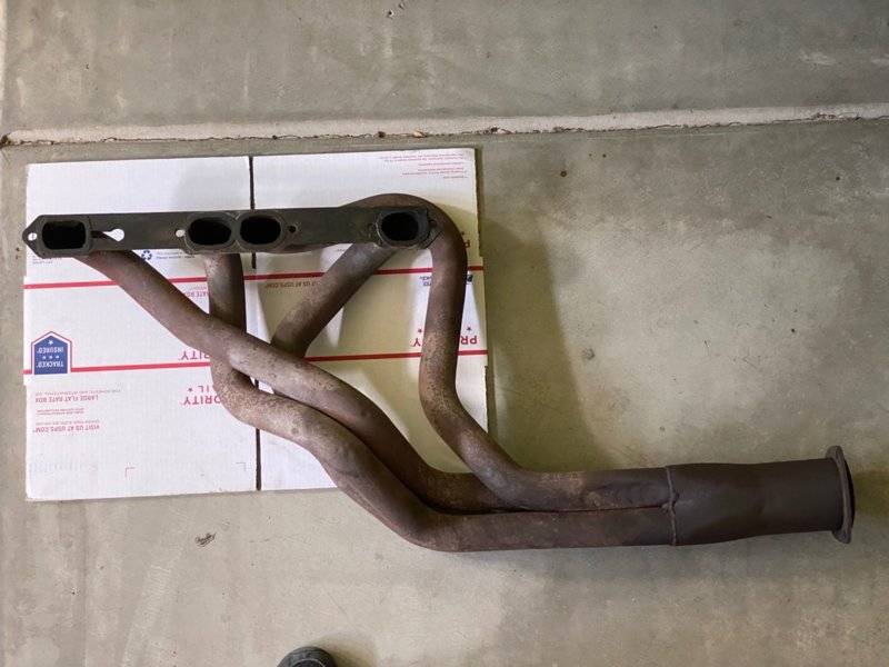

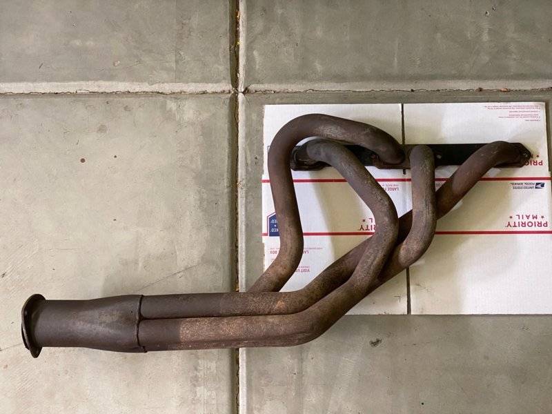

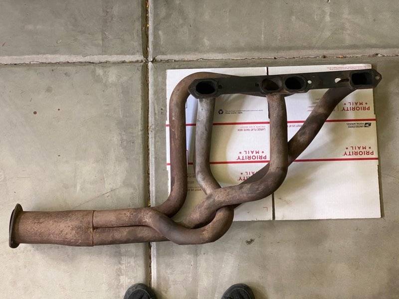

These are the unidentified headers that were on my car and will not clear the Borgeson box. I measured them with a calipers. Tube diameter is 1 7/8". Collector diameter is 3.5" There are no brand identifying marks on them that I could find.. The passenger side one, near the collector, is especially stained with coolant and ATF fluid which dripped on it during this project a few weeks ago.

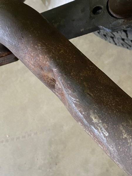

You can see the dent that was put in the lead tube to clear the stock box. Along with fresh scrape marks near the dent where it rubbed against the borgeson box, during my failed attempts to mount it to the engine head.

Those do not look like any header that I have ever seen.
Judging by the condition, maybe a manufacturer that went out of business at least 15 years ago ?
