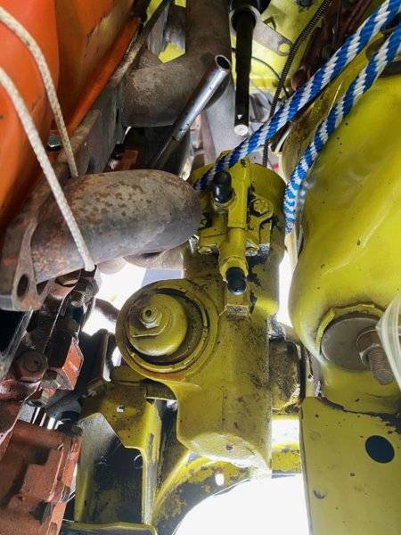

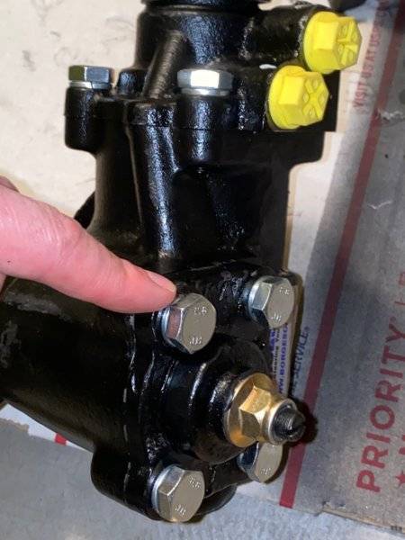

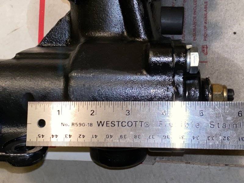

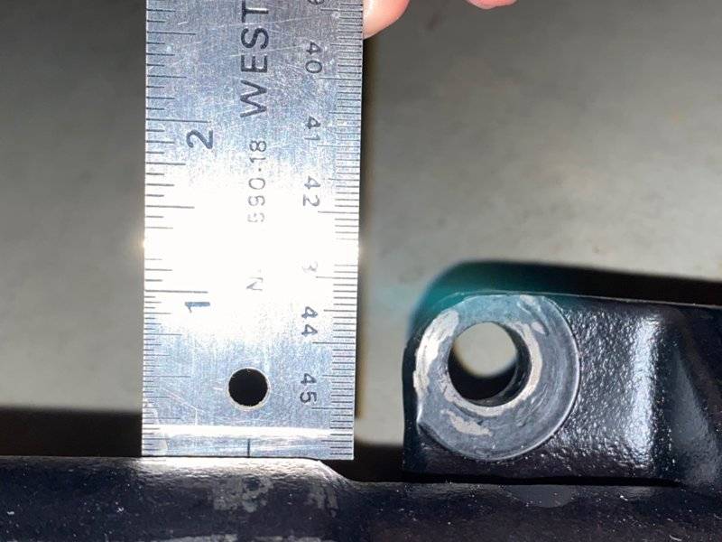

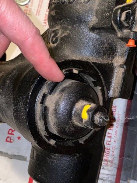

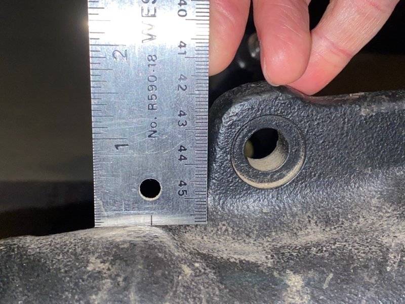

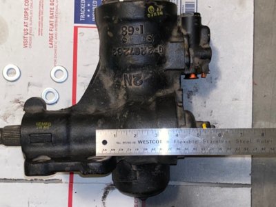

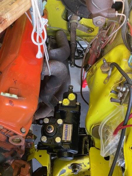

Yes, the Borgeson box is shaped differently than the stock box, the castings are completely different. I took measurements tonight to determine WHY the Borgeson box will NOT clear my lead header pipe, yet the stock box does clear it.
The stock box may be BIGGER overall, but it is SMALLER where it counts, in the lead #1 header piper region. The top of the sector shaft casting is taller on the Borgeson, bringing it up higher towards the header pipe. The side of the sector shaft casting is closer to the mounting holes on the engine side of the box. This brings the Borgeson box physically closer to the engine than the stock box is, this also allows less room for the lead pipe. Thirdly, the rounded casting of the top sector area on the stock box, which also has a domed top, gives again, more clearance for the lead pipe. The Borgeson casting in that area is more rectangular and has those protruding bolt heads, that get in the way of my lead header piper as well!
The photos show why the Borgeson doesn't allow clearance where the stock box does. If you want to run headers with this Borgeson box, you better make sure the #1 lead pipe runs straight back with no downward travel..

I've looked at your pictures and read your comments and I am not really seeing what you are saying, but I think I understand it. My initial thought is that your headers are your main problem; they look like old school Thorley or something which never fit well when new. I have a stock box in my Challenger and am running Schumacher Tri Y headers which fit exceptionally well, problem is that they have shut down. I realize that TTI's are expensive but I know they fit. This is hot rodding at its finest, most of us have been there many times trying to make things fit.
If you want to use the new box, you are going to need new headers or manifolds IMO. You could always build your own headers...

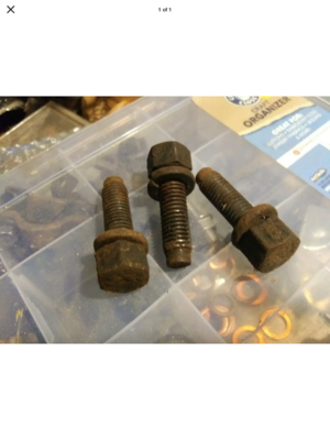

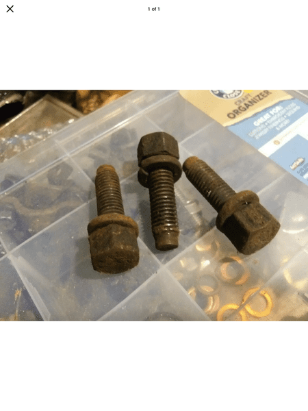

I was having the same problem putting in my rebuilt steering box. Make sure u are using the correct bolts. I tried just plan grade 8 bolts they wouldn’t go in more then a few turns then I tried the correct bolts they went in but super tight I thought I was stripping them The correct bolts have some cutting teeth on them.
I didn't use the original bolts, they were "super tight" going in, like you said. I didn't want to strip the threads in my K-Frame.. I've read that bolts should NOT be THAT tight going in because you cannot get accurate torquing of them with your torque wrench. After using the ARP chaser, new grade 8 bolts go in my K-Frame and will torque accurately. Also one of my threaded holes was cross threaded somewhat, after removing the stock box which the ARP chaser fixed.
