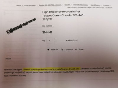

I kind of like the description of the Voodoo 701 cam too, good vacuum, works with PS, PB and A/C. The 1000-5500 rev range sounds good too. The tires are 27 inches tall, which gives me around 2500 rpm at 60 with the 3.23's.

I used this Crane split Hyd. in a 318 a long time ago. It was very good and has the same description. My P/B worked excellent. I also had 3.23 gears on stock sized tires on a low compression engine/904 trans, headers, 600-4bbl. NO converter change needed. Good cheap thrills. The lil’teen ran high 14’s. 19 mpg’s Hwy.
https://www.summitracing.com/parts/crn-693941/make/dodge
216/228-.454/.480-112
The Lunati would be chooses now. 1.6 rockers employed.
