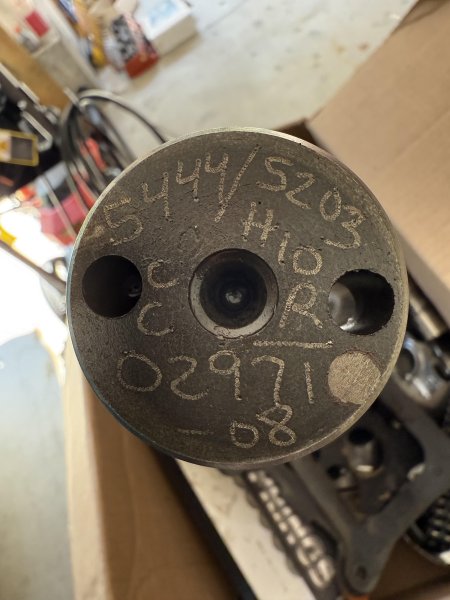

I pulled this flat tappet cam from a 440. The engine has stock intake, stock heads and stock exhaust manifolds.
Looking for help identifying the manufacturer, specs, etc. What might have been the intended goal using this profile?
Appreciate any feedback.
Check with Howards Cam's,, I remember seeing that style marking on a old Howard cam back when I had hair..
Looks like a Comp Cam, " C C "
Check the lobe #s in the comp lobe master charts
5444
Xe int 270 226 .482
5203
Xe exh 280 230 .480
The exh lobe appears to be an old magnum series not xe , but would be a nice street/ strip cam
IMO, it’s an okay cam for the engine it came out of. Maybe just a little too much for stock intake and exhaust manifolds, but certainly okay
Would the H10 be hundred and 10 LSA?
Speculation but, most comps are a 110°
The XE production cams used Magnum lobes for the exh because they are less radical. The exh valve opens under compression pressure.
