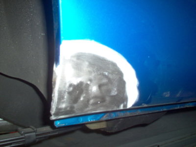

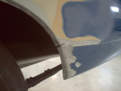

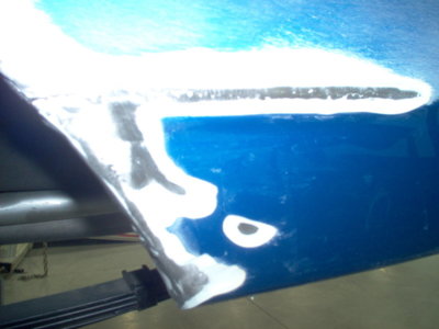

This is how "Restorations by Julius" handles bodywork. Backstory: cracking paint, a few polite calls & discussions with Julius, who remembered the car.
He provided no answers or even consistent stories, only "never had a problem".
The bodywork & paint was not tampered with since leaving his shop.
Finally started digging into it, and this is what we found (quick & sucky photos):
Lt quarter lower patch panel barely welded, and beat on apparently with a ball-peen, then over 3/8" of bondo on top.
A few rust spots on the right, a good 1/4" or so of bondo over that.
Other areas with no damage underneath, also 1/4" of bondo.
I'm utterly mystified as to why, let alone the sheer nerve involved in such crap work.
Bonus points: missing parts, incorrect fasteners & finishes, etc found during disassembly.
Rest assured the car is going down to the bone and being re-done.

when was the car restored
it's all about the money. they obviously don't give 2 shits about doing it right the first time
I've heard from a couple other guys previously to tearing into this car, who also had problems. There's absolutely no valid reason for work this poor. It was restored some years back, but no matter; my shops have had a lifetime guarantee on our work, and cars we did 30+ years ago still look the same as when they left the shop. But we never hacked them, either...
