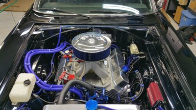

Mine is hidden under the battery tray in the engine compartment. Very close to all the connections to be made, stays cool, accessible and fits very well there. Best of all? No one notices.

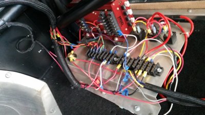

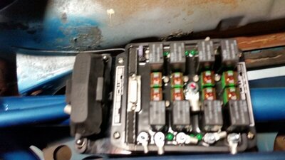

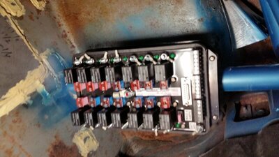

I have always mounted them under the battery tray in the engine compartment. My current set up, MSD Grid, RacePak data logger, fuse/relay panel, 4 stage nitrous controller are all mounted under the dash on the knee bar.
