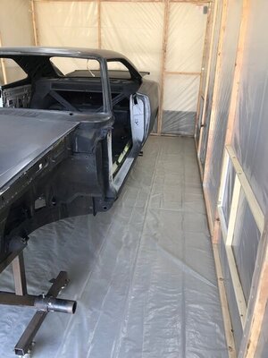

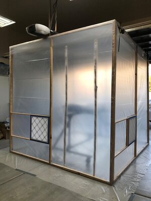

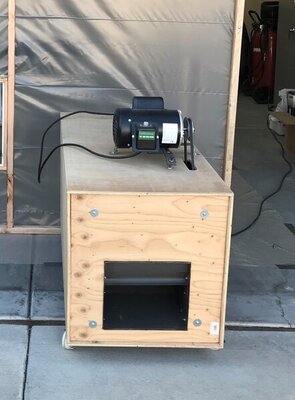

I started off building a 8 x 8 x 8 modular panel booth to do some smaller parts, then I expanded the size to fit the entire 17 foot long Charger in ( 12' x 20' now ). Constructed out of 2 x 2's, poly sheeting, some filters and of course I had to build my own blower system which I used a repurposed squirrel cage and fit it into a plywood box. Since I didn't want to spend a small fortune on a explosion proof electric motor I designed the blower with the motor outside running the squirrel cage, works better than I had hoped actually. The system as a whole is built to be modular. I can take it down and resize it to what ever I need at the time... It controls the overspray, bugs, dust and evacs the vapors easily.

Thanks! That looks great! Looks like it's in your garage or is it outside?
