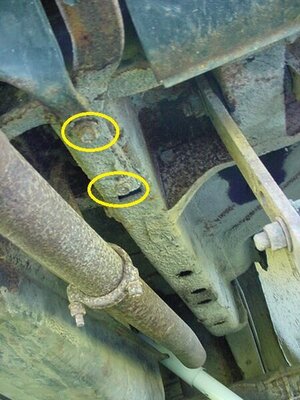

Here is a picture of the inside frame rail on the passenger side. Show the stock location for the tip hanger, and the other is the hanger for tti exhaust.
Just to add FWIW, I've replaced the passenger rail on my 71 Satty that originally had a single exhaust with a rail from a 73' RR that had factory dual ex. I left the u-bolt in the frame where the hanger mounts(got the hangers with the rails). Here's a few crappy pics but it isn't a self tapped location. I believe the location further towards the front about 10 inches or so is from differences between the charger/RR tips, or the resonator option. Not sure I could be wrong, dont matter to me...
The drivers side rail on my 71' is original and is identical as far as the "knockouts" in the rails for the tips/exhaust hangers...

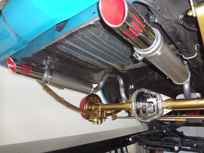

Well looky what I found in my exhaust parts stash-
Here they are mocked up.
I think they will work in the intended location after all.

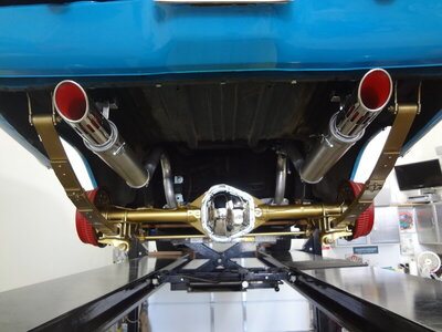

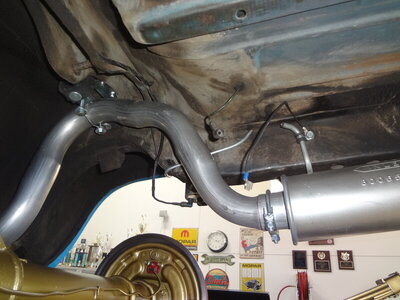

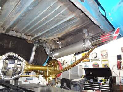

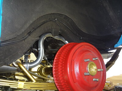

Here are pix of my 73 RR GTX when I replace my exhaust.
hope this helps.
