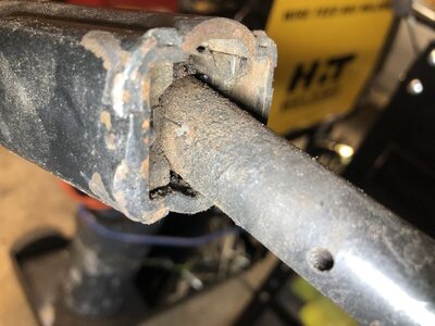

So as I am examining the “pin” I need to knock out I see that there is a hole all the way through it. Does this mean that its not a solid pin but a rolled pin with a hollow center? Its difficult to see the pin due to age and stuff and I don’t want to start tapping until I know what I am tapping.
Correct it's a roll pin.
Find a correct size drift and tap it out.
Might come out easier one way than the other.
Check your coupler for play in the two shoes inside before you remove it.
Grab the coupler with one hand and try and turn the steering shaft with the other.
Should be very little movement, if there is look up steer and gear.
There is not a real need to remove that coupler from the splined input shaft on the steering box, the steering column part can be pulled out as there is nothing holding it inside.
The shoes and spring will just slide out of the coupler.
Good luck getting the cover back on.
I'd knock out the roll pin.
But if you are replacing the seal on the collar that comes through the firewall then yes take the whole thing apart.
The above info is wrong the shoes will not come out of the coupler until the dowel pin located at the top of coupler is removed.
However while it is out I would take off the cover, check for wear and pack some grease in it.
It is easier to take the coupler out in one piece otherwise you have to try and load all those parts in to the coupler body working in the engine bay. Someone else has the hold the column for you. Next to impossible to do by yourself.
I couldn't get my pin out so took the column out and left the coupler attached. It's a good time to clean up and regrease the shoes inside the coupler. I got my cover back on with a bit of patience and luck.

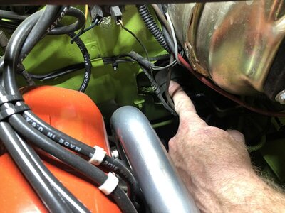

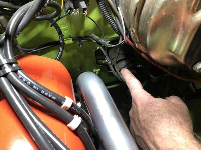

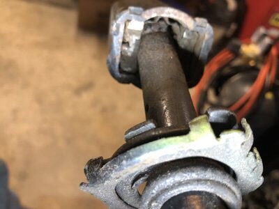

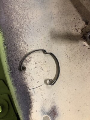

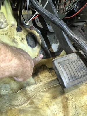

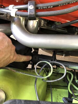

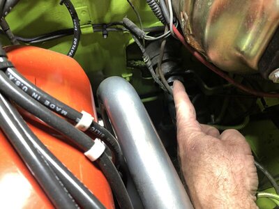

So I pulled the roll pin on the master Spline coupler. The column is tight to fully disengage. It has moved just over a 1/4 inch. But I am concerned about the assembly up at the bulk head. The trans linkage does that have to come off to get through the fire wall? Also that large collet has a spring clip in it that I removed. At this point she is hard pressed to come through....
7D40D425-D250-4E42-956E-78CFE1593542.jpeg 27A5125C-6D70-46E8-B6A6-9A6023AA4CF6.jpeg ED7ABEA1-E5C4-4429-AADB-C0620D2A3BD5.jpeg 632DBD49-1CEA-4313-A6DC-EB514DAE2126.jpeg image.jpg
Did you take the fasteners out of the plate/seal at the firewall?
The plate with the two 1/2” bolts yes but I am concerned about the trans linkage and collet near the firewall not clearing the hole in the firewall.
Does this plate have to come out to?
Yup I just pulled it off and the column dropped! Made it through the firewall fine!

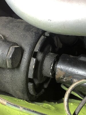

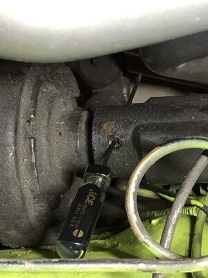

Yup that doll pin is obscured from the outside shaft by crap etc. but its obvious now looking at that it will need to come out. If I am in here what should I replace, machine etc (other than shes and seal)?
