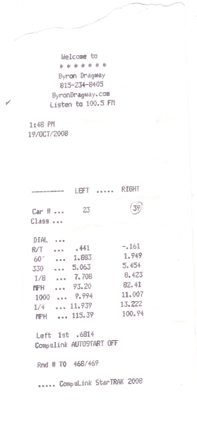

Here is my set-up:
70 RR
383 .030 Over
TRW L2293 Pistons
Doug Herbert Cam 245 @ .050, .510 lift (I think)
1 3/4 Headers
3" Exhaust
Auto w/2800 RPM Stall (RMVB)
4.10 Rear End
Holley 770 Avenger
Edelbrock RPM Heads and Intake, 1.5 Roller Rockers
Electric Fuel Pump
MSD 6AL and Probillet Dist.
13.22 @ 100.94 This was with stock iron heads before the edelbrock intake and head install - should be quicker now.

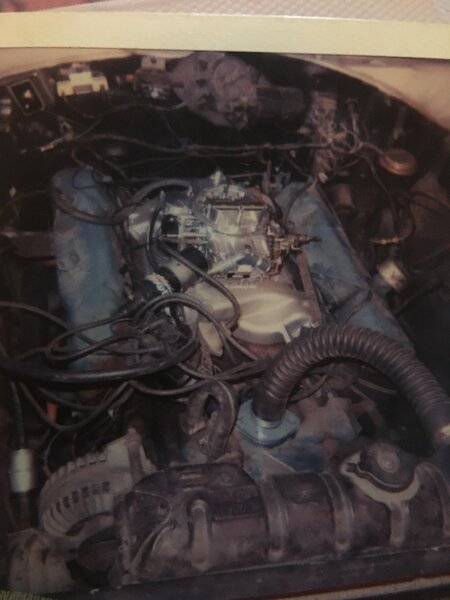

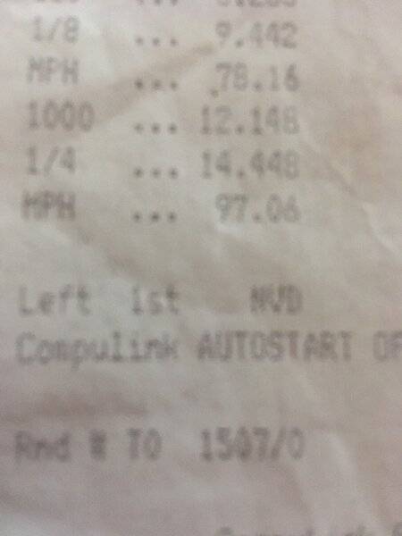

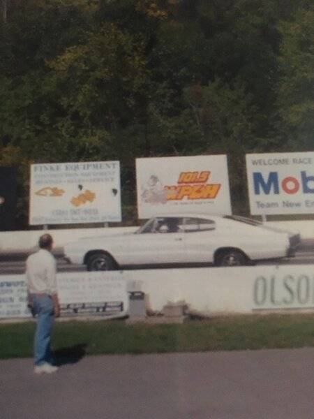

1967 2bbl 383 (59,000 miles) Installed in a 1966 Charger, changed the 2bbl cast iron intake to a MP duel plane 4bbl, with Holley 750 vac 2nds, and straight duel exhaust(no X or H balance tube) and Hooker super comp headers. and Mopar electronic ignition chrome box, Mopar blaster coil, smog 400 distributer 3.23 sure grip 14inch cooper cobras
best run 14.2 @98mph. avg runs 14.4 @97
That had the stock 2bbl cam, nothing touched inside the engine.
I just posted photos of this car yesterday, on a different topic,LOL
Sorry they are photos of photos, so they are blurry.
In real life the one of me returning from a run with the 14.2@98mph time on the score board is one of my favorite.
From 2002 or 2003, Hemmings MUSCLEPALOOZA #1!!!!

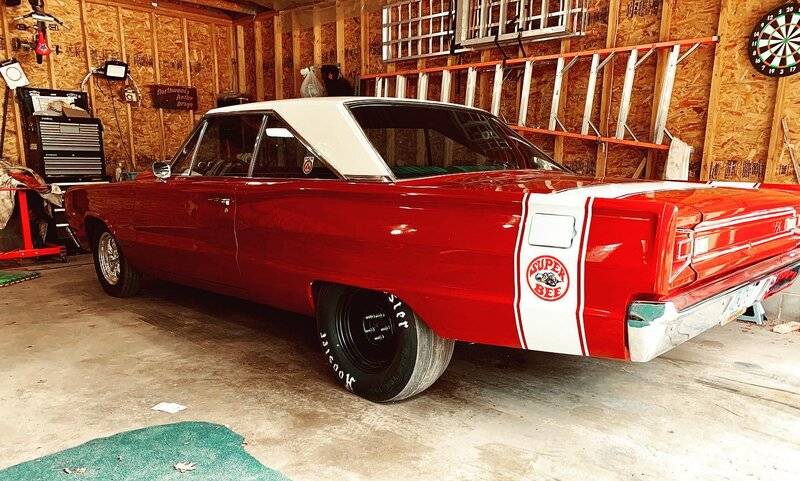

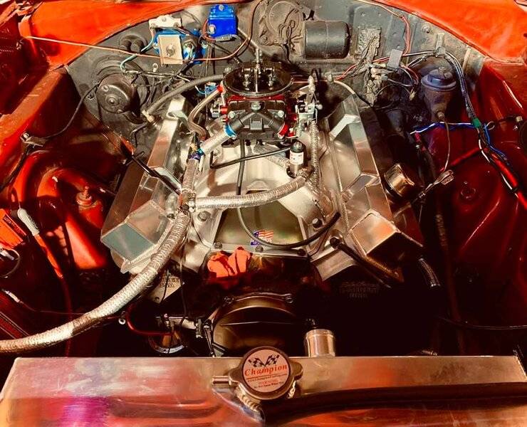

I have a 10 to 1 383 with Edelbrock E Street heads, Comp Cam 275/287, 525/525 lift, headers, Trick Flow Track Heat intake, QF Race 750. 4000 stall street-strip 9.5 converter connected to a 727 with a brake, 4.10 gear in my heavy Coronet. Very strong combination, I put a line lock on the car and decided to upgrade the master cylinder and pro valve. Once it's back together I'll run it on a Wednesday night at Brainerd see how fast it is. On the transbrake and 2 step if I launch it at 3200 rpm it feels like a mid 12's car in it's current set up.

Single pot Jackpot??? Livin on the edge:poke::popcorn2:
