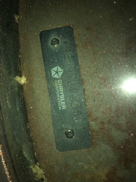

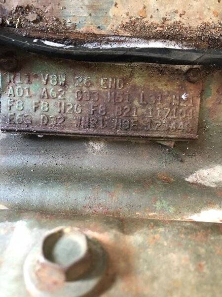

If it's a real Super Bee it's worth more than $1400. Can you post a picture of the VIN plate and fender tag? Do you want to sell the car? Most of us on here would give you more than $1400.
The Vin plate which is on the fender inside the engine compartment would tell all of the options. If the number starts with WM21 then you definitely have a true super B “post” car versus a hard top. Post car means that the window section between the front door and the back window has a post that runs from the roof down to the door. You would also have to check the radiator support as well as the driver side rear trunk rail to see if those numbers match. If you dig deeper you could check the engine and transmission to make sure they have the same number if all of those match then you have a numbers matching super B. I am currently restoring a 69 super bee hardtop. I paid $8000 for mine. It’s all numbers matching and complete but was far from running and driving. The engine was locked up, tons of rust all around. Hope that gives you a good starting point. I’d say they’re probably worth even more now.

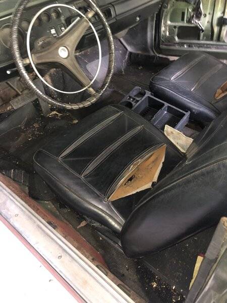

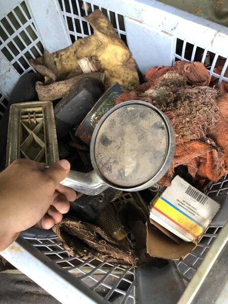

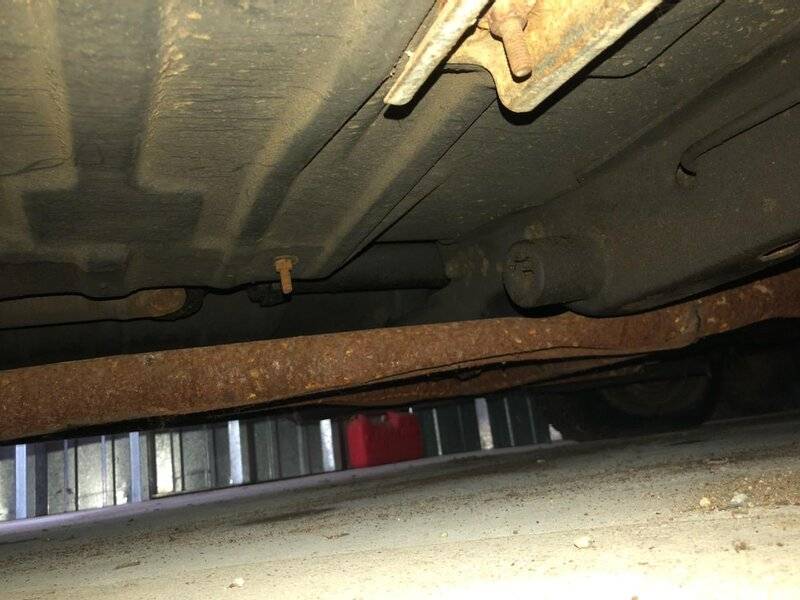

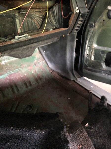

How does the interior look? From the pictures it looks like it’s missing the rear window trim as well as the quarter panel extensions. How soil is are the floor (truck and main car)

F8 green, automatic, 727. Bucket seats. If you’re lucky if you lift up the bottom section of the backseat there might be a broadcast sheet between the springs in the bottom of the seat. That would tell you a lot about the car as well

That's really hard to see. Take a better picture of the VIN plate if you can.
