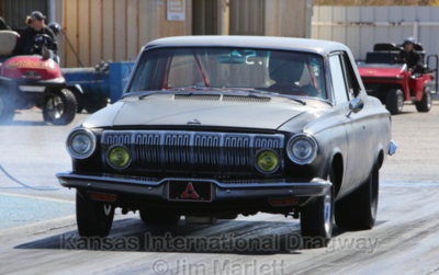

I did the Wilwood Pro Street kit (vented rotors) that bolts to the drum spindles. Very happy with it. Not sure it it moves the wheel in or out as I never ran the car with drums. They have lots of street miles and bring the car down from 133 mph on the track just fine.
Thanks very much for posting the photo, the wheels on your ‘63 look like they should. I don’t get these kits that when installed stick the wheels out, some put the tire/wheel even with the fender, and It looks like hell to me. I’m sure every marquee has suffered from this early on, until someone or company steps up! You ‘63 Looks great! Thanks
Thanks! It's far from finished but I'm having fun with it.
We race some small, short shutdown tracks and the car weighed 3,720 lbs. this weekend (with some ballast) so it takes a lot to whoah it up!
I would love to build a fun car like this, in fact, I found one in California, however If in forking over twenty I what to drive it to more than races, but I did consider selling the cvert lol, but came to my senses! I love what your doing there, the car looks awesome on launch!
I did decide to build a Max Wedge clone replica etc, obviously I probably won’t be racing it (I don’t think), maybe at a nostalgic event, anyway sorry got off subject, cool car and thanks for the input.
