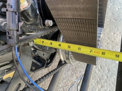

How far is your blower belt past your water pump snout?
Here is a photo of what fits on mine. Being you have a charger I thought I could help.

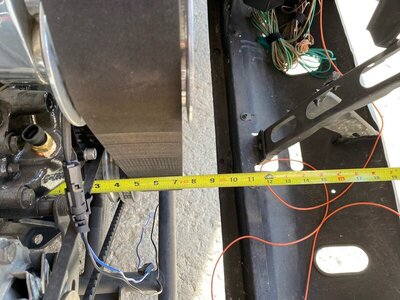

Here's a few of the measurements I'm working with...
Yes sir, tape goes to the timing cover. Mainly just to show the distance from each relative part.
I will try to measure what I have and get back to you. I also have another idea I will run by you then.

I am at 6 inches from my cover to the furthest point out which is the water pump. So it looks like you need 2 more inches. To me it looks like sectioning the core support and moving it fore ward 2 inches and a custom radiator with a low profile double suction fan/shroud.
