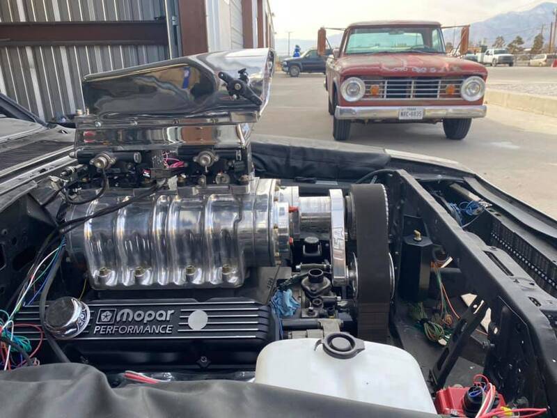

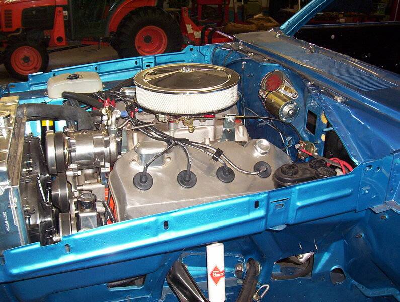

I saved this photo of a members car from here but don't remember who and don't have the details, but I'm in the same predicament as you with no room, especially with the '65 engine location.
Any way here's the photo
Any here's the photo

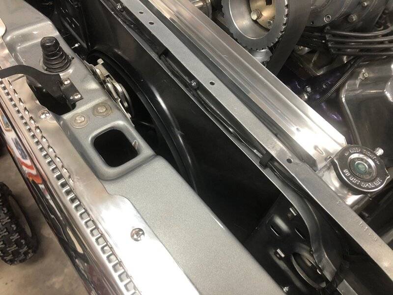

Awesome starting point. I'm going to run into one big issue, which is the brace running from the lower radiator support and the bracket for the hood latch release.

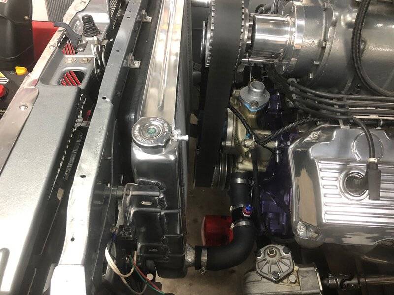

I'm currently trying to solve our heat problem and thought about going in front like you, had a double pass Afco with about every fan configuration you can think of, but pushing due to lack off room, finally put a Flex-A-Lite 15-inch Black Magic Xtreme S-Blade reversible electric fan rated at 3,300 cfm and as long as your moving it's fine, but when stopped it starts to creep up.
So now I'm trying a Northern triple pass that keeps our 500" cross ram Hemi cool with the normal 2 fan puller setup
I had to space the radiator even closer to the pulleys to make room for the big fan and shroud, but this is how the Afco was also.

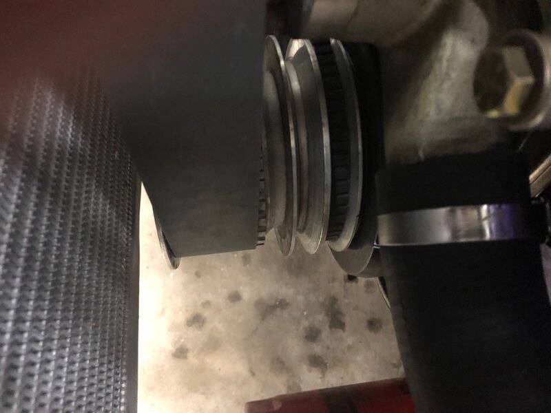

How far is your blower belt past your water pump snout?
Here is a photo of what fits on mine. Being you have a charger I thought I could help.
Jeff, are you running a 3” or 2.5” belt?
It's only 2"
I'm sure I could gain by getting a new snout, pulley setup ($$$$) but again, I'm also fighting the 62-65 mounting position.

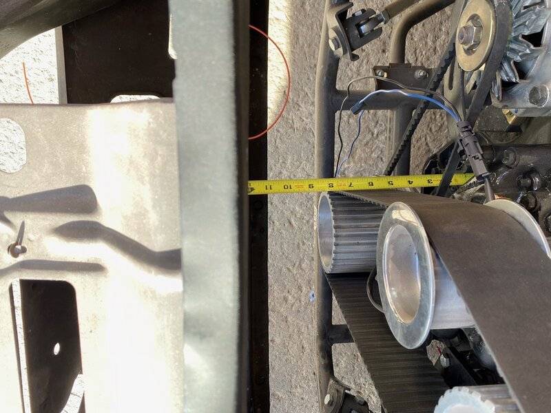

here's a pic of the pulleys, like I said, there's wasted space here!

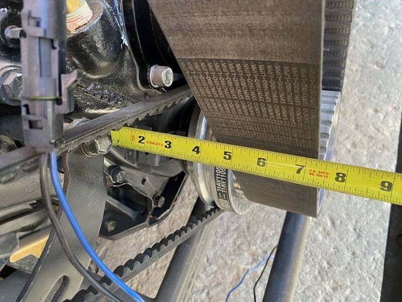

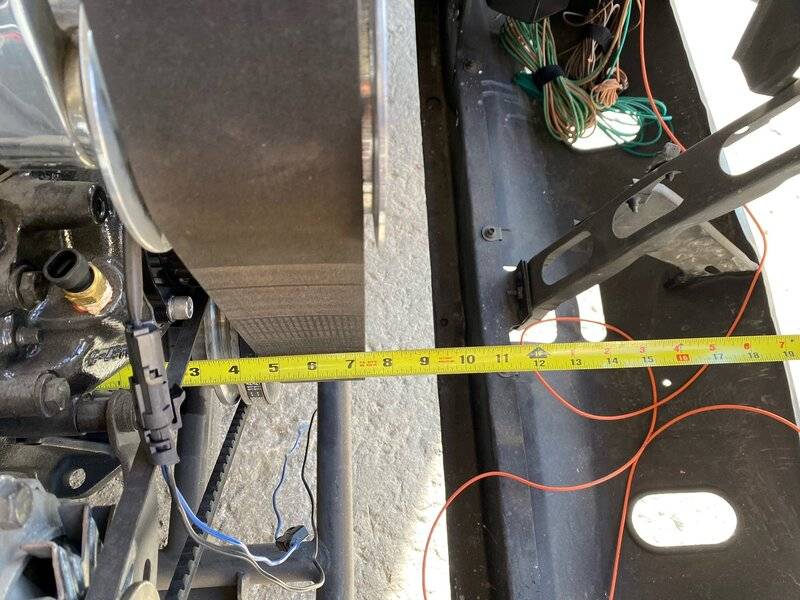

Here's a few of the measurements I'm working with...
Yes sir, tape goes to the timing cover. Mainly just to show the distance from each relative part.

I am at 6 inches from my cover to the furthest point out which is the water pump. So it looks like you need 2 more inches. To me it looks like sectioning the core support and moving it fore ward 2 inches and a custom radiator with a low profile double suction fan/shroud.
