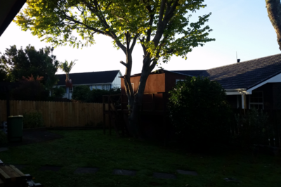

Here are some pictures of the shed build....started with the part slab that was hand mixed by my brother about 18 years ago - he built a two-story playhouse for my kids. The underneath was used to store the lawnmower and firewood etc. Sadly, the plywood starting going bad, and the tree wreaked havoc upon the roof eventually. There once stood a huge Elm that spanned both sides of the boundary, as well as touching the peak of the house roof behind us. My wife and I took to it about 4 years ago, and then I got the Pro's in 3 years ago when the local authority announced open season on any trees of no interest. Chop and gone now.
See how much higher the tree is compared to our house....the rear gutters rotted out due to the continual dropping of leaves...
