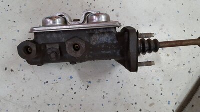

Would you happen to have a pic of your original m/c?
68 Coronet R/T original M/C
67 GTX original M/C
67 Hemi GTX M/C
All 11" drum brakes. I'm not 100% sure the 68 R/T is original, but they work great.
I'm thinking they're all the same bore - and Fred has the same lid type as your '68 - but I think the
other two are indicative of what he should have had originally?

Yep, that's what I thought (and @Jerry Hall said too). Mine is the flat plate with a bolt down the middle
cap type and it was new when I got Fred over a decade ago - but no matter how much bleeding is
done, it's always felt crappy, so I don't trust it. It'll get gone eventually.
Wonder if that reproduction Bendix one everyone is selling is any good? Gotta be Chinese, I'd thnk?
Ed, spongy even after bleeding sounds like a M/C issue to me. Brake shoes, and wheel cylinders will not cause that. Flex lines bad in the front will cause severe pulling to one side or the other, and in the rear will cause a rock hard petal. Petal feel and/or height comes from the rear brakes. I would ofcourse pull all the drums and inspect shoes, wheel cylinders, and the springs for wear or leaks, but the M/C and rear brake adjustment are responsible for petal feel. IMO I would take a serious look and/or rebuild/replace the M/C first not last. May save you some $$$.
And the Master is the easiest thing to replace.
Bench bleed leave the lines just a bit loose pump once or twice and tighten.
Yep, why I keep asking questions about the master cylinder. It may well be the newest component of this system -
but I don't trust it, after repeated bleedings and adjustments of brakes. This is not the pedal feel I recall from old
days on these cars...only question is, if I don't bite the bullet on one of those repro masters floating around the
vendors (China) right now, what the heck else is there? I didn't see much else digging around.
