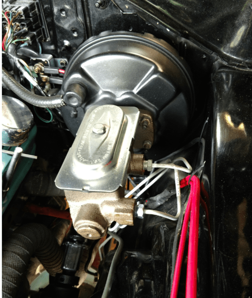

Why in the hell could they not have done "studs out" to mount the m/c? Never understood that.
Sorry, you're right I was thinking of my 66 which is the easiest thing ever.
My suggestion is take the seat out, beats trying to wedge through the door opening and over the sill plate.
The way I recognize cars that I have fooled with the M/C on is that the two top bolts that go in, I reverse them so that all 4 are out if I have to remove the M/C again. I agree those 2 are tuff.

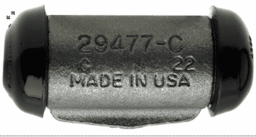

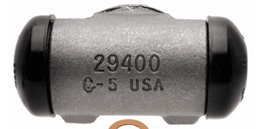

I just purchased both Raybestos and AC/Delco wheel cylinders for my ABody, all made in China. Don't get your hopes up per post #15 that NAPA carries USA made components. If they do, please let me know. You can easily rebuild wheel cylinders, but then again, where is the rebuild kit manufactured?
The only reason I'd think they do are the pics they have for each.
From their website:
Front
Rear
Eh, for what it's worth anyways...
From their website:
Front
Rear
I ran into the same problem about 3 years ago when I rebuilt my brake system. I got all excited when I saw NAPA's pics of the wheel cylinders. When I received them they were China made.
Good luck and let us know how it turns out for you.

Oh yeah, I'm very dubious of the claim for sure - but since I know the fella that runs the local
NAPA, there's gonna be some face time before any money is laid down for those for sure. :)
