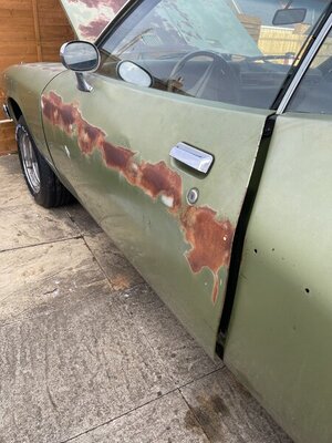

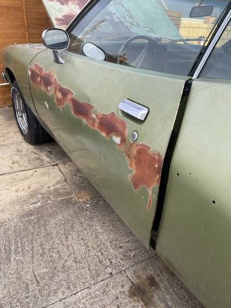

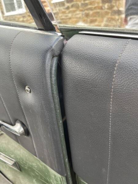

The drivers door on my ‘73 satellite is stuck, it will open a little bit but seems like it’s stuck on the latch maybe, does anyone have any ideas of what it could be or what I could do to get it opening?
Just imported the car to the UK and it arrived this week, is my first car like this and am a little lost for what to do or try!

I’ve thought it might be but have tried quite a few times and it still isn’t opening, have tried spraying loads of wd40 on it and also trying to use as much force as possible but it just won’t budge

It seems like it’s caught on the latch maybe, only opens a tiny bit and gets stuck

This may sound corny, but it’s hard to tell from the pictures. Is the car parked at an angle on an incline?? Hope this helps you.

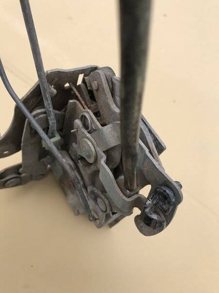

Could be that the safety latch isn't fully releasing.
View from the top, fully latched.

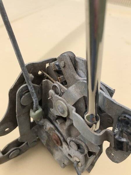

Roll down window, insert a push rod here. You can see this from above, I've verified this on my 73 Satellite. Push down.
This is a 1/4" metal rod, A 3/8" might be better, 1/4" drive extension also works.

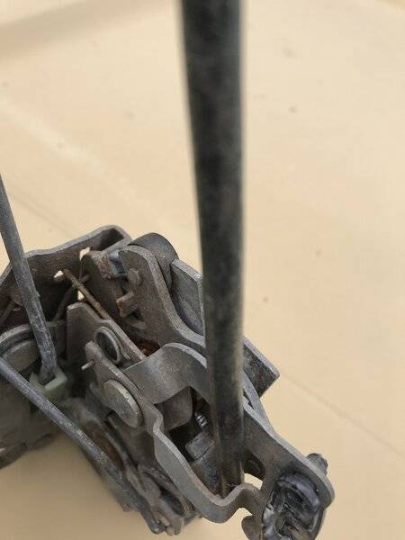

How it looks pushed down and fully released, notice the gap in the latch levers at the top.
Hard to see this through the window gap at the top of the door. While pushing the rod down try opening the door. IMG_1510.JPG
