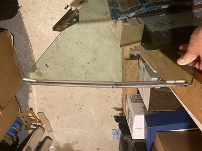

Thanks but those aren’t what I was referring to, here’s a photo
DF8B9E1E-ACB7-44F9-9DE2-97F807B0B8BF.jpeg 822A925C-DABE-4DC2-A51D-A573C90CC1BA.jpeg
Those acetal sliders look good to me.. and you'll want to reuse them if they are!

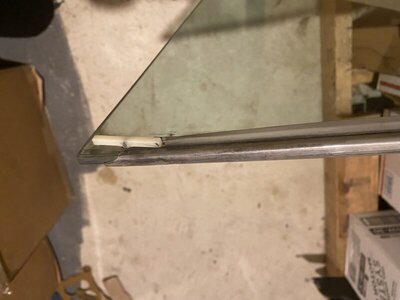

I took a picture of the better glass, other glass half of one is missing and has no plastic sleeve at all.
We're talking two different things... the white acetal sliders and steel pin that joins them. If they aren't cracked, reuse them...
we are talking about the same thing, one slider is broken off the other glass
Okay, calling it a "sleeve" lead me to believe you were talking the mylar flocking..

mylar , couldn't think of that word either. couldn't those guides be made from some composite material and pinned like the original design, they don't look very complicated.
