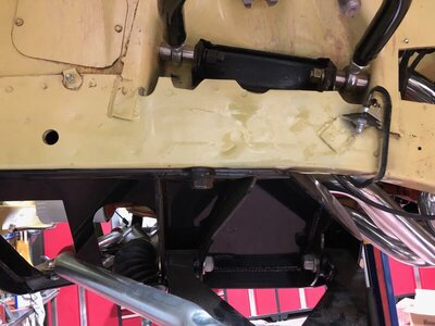

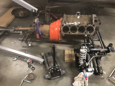

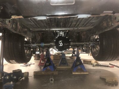

I just joined as I want to help someone else avoid all the headaches! I purchased a full front coil over and Dana 60 from them, about $10k, in January 2021. Starting late March I started questioning where things were by late April Jen indicated her supplier of rear ends (Strange) wasn't returning her call, possibly not paying but that's a guess. I looked into Moser and forwarded their response to her. Early May received a Moser Dana 60 but not powder coated as paid for. Where is the suspension? About same time received K-member, steering rack, some hardware and control arms. Whats missing, "no clue" since there is no packing list or instructions. Continued to complain and received a set of outdated instructions that were just bad! Been wrenching for 25 yrs have a bunch of experience so I am able to figure things out but COM'ON MAN! After going thru parts in detail, there was no coil overs, no steering knuckles, no zerk fitting for lower control arms, and no conical spacers for upper control arms. Not much of a suspension! After continued complaining I received the coil overs and steering knuckles. Never did receive any additional hardware, including conical spacers or zerk fittings. Started putting the thing together, wow now the fun starts, knuckles don't match the holes on the stock spindle as they indicated they would. Machined it so it know works. Tried to install onto lower ball joint but knuckle on left side is over reamed and knuckle on right is under reamed. Oh well used spacer on the left side and bought reamer from McMaster Carr for right side. Measured upper control arm mounts and bought spacers from McMaster Carr to install those. Instructions don't mention having to cut anything of the car, which was important since this car is an original 69 Road Runner, but no such luck you need to cut the bump stop bracket to allow there K member to fit. The hardware for the K member is 2" long 5/8" allen head bolts! OK so 2" long, do the math the steel on the K member is 1/8 and is doubled in the rear hole, then the internal bolt is at least 1/4 to 1/2 from the face of the frame, then there's the split washer, and get this no flat washer. Based on the head of the Allen (7/8") and hole on the k member (3/4") I'd say that's a bit sketchy. Also the motor mounts are stock Mopar with the 1/2 motor mount bolt (welded to mount) drilled out. This makes little sense to me, why not just use the welded bolt. Instead they drilled the bolt out and did it poorly. They apparently didn't put the item in a jig and just drilled, which bent the one side of the mount. To make these work I drilled the hole to 9/16 versus the 1/2 and to best of my ability bent the mount back. I've included a few key (insert comical) pictures. If you bought this kit and already laid out the cash, I can help with some pitfalls but like me you skrewed up "sorry". If your looking I say go to QA1 they just purchased Gerst Design. The rear of my car is all Hotchkiss and the stuff was right on and everything came on time with packing lists :) Please share this with any and all, while these people may be nice, they shouldn't be allowed to mess with people like this.

Once the stuff was installed it's pretty solid but certainly I wouldn't do it again. I will keep an eye on the welds, since we all know while they may look pretty it doesn't guarantee quality. Will also keep an eye on the coilover mounts, I don't like that they mount to the stock sheet metal, I may fab something up to give it more support. As far as torsion bar, there isn't anything wrong with them but you can't get the adjustability (coil overs double adjustable) from them and stock ones really don't cut it. I suppose updating them to some modern ones (maybe Hotchkiss) would be fine, I think those have more adjustability built in. Also these modern kits change some of the key suspension geometry that you will notice when driving hard. It really depends on how you plan on using the car and what type of driving you like to do. But there is nothing "wrong" with torsion bars.
