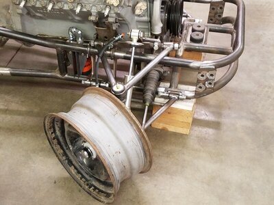

The frame.
Factory 5 concept. 1-1/2" OD chrome moly.
We jigged this up on on a frame table we built
using I-beams. The pics for this process are
on my laptop (it's dead).
Chassis;
Wheel base - 108"
Koni drag shocks
Mustang II R&P
90 deg miter box steering (from a GM bus).
Front disc-Ford/ Rear disc-Jeep
Rear diff- Chrysler 8-1/4* sure-grip with girdle.
3.55 A/R
*8-1/4 rear diff used due to weight savings. With
rear disc brakes, the axle isn't gonna come out
if a c clip fails.
