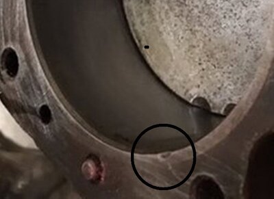

In picture number 2 at about 6 oclock , it looks like a chip out of the deck at the edge of the bore.
I'd be afraid the fire ring would be about halfway compromised.

I did see the chip. It did concern me a little bit. I would hate to have to deal with a messed up fire ring. Maybe this one is not the one after all. Thanks for bringing it up!

If this is the "chip" everyone's in a panic about it sure isn't something I'd be concerned with !! It doesn't appear to below the taper.

Thanks for the comment. You don’t think this chip would be a problem?
No problem AT ALL. That line you see around the top is the taper to install the rings. The chip doesn't look to go much below that line. And the top ring will be sitting AT LEAST 1/4" below the deck. I've seen valve reliefs filed deeper and further down than that.
Thanks for letting me know. I will keep this in mind. Maybe I can use this to bring the price down.
Absolutely! Say something like: "It'll probably need to be bored 60 over to get rid of that and then It'll need new pistons and then the walls might be too thin - I dunno, maybe I should keep looking for a better block that doesn't need all that"
