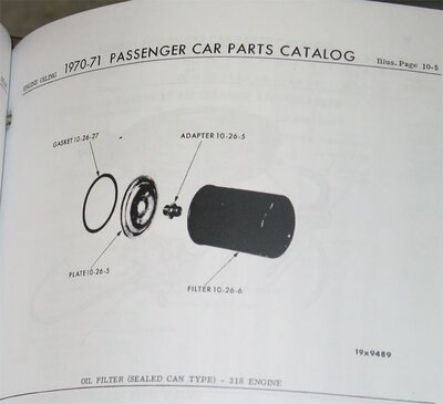

On the POLY the sender sits next to the distributor. I've checked and it is clean and dry. No signs of oil dripping down the back of the block. There is an O ring gasket between the filter base and the block that I will look at. I found this pic for a 70-71 but I believe it also applies to the poly
