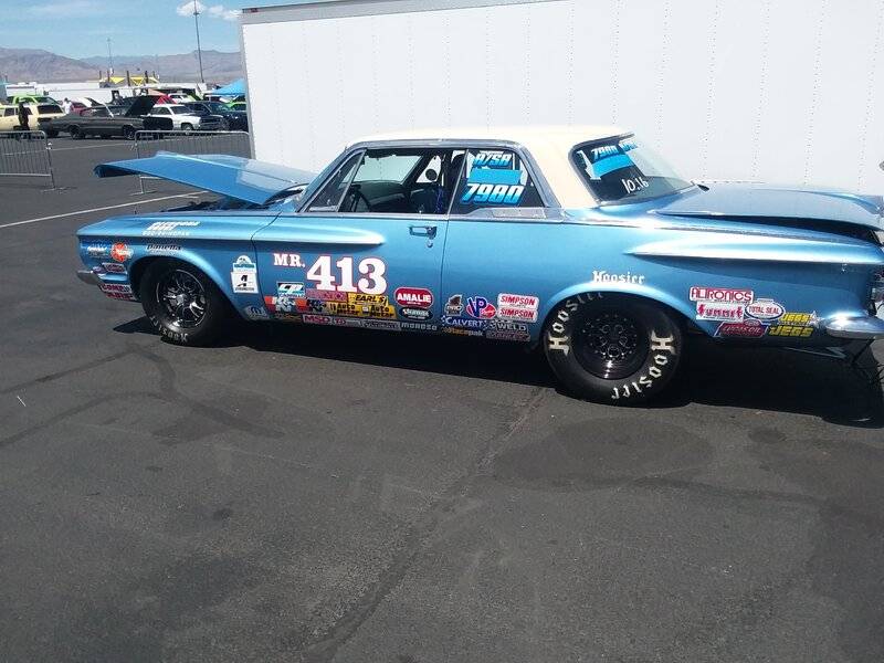

My Good Buddy and Mentor Steve Wann runs Mr 413 62 Plymouth
My friend Dwaight Machel is right behind him in his 413 Stocker 62 Plymouth
40 years ago = before Steve was old enough to race - He used to go around the
pits and tell all the racers how he was going to kick everyone B*tts!
Sure Enough he was not Joking!
pits and tell all the racer how he was going to kick everyone B*tts!
