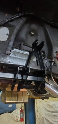

Doing a install QA1. Decided not to pull the motor and trans. Took every thing off except the K frame. Supported the trans with a large (1" diameter) tent stake. The lower and upper bump stop brackets must be removed. I cut them with a torch. Then ground off the remaining areas near the spot welds. Supported the engine with a trans jack. Removed the motor mount bolts to the K frame. Pulled 4 frame bolts. Removal went smoothly. Installed the new QA1 part without issue. The new K positions the motor back 1.5". Had to figure out how to pull it back. Two ratchet straps working a little at a time got it done. Started all the new mount bracket bolts. Finished pulling it into position. Engine and headers fit. Trans shield is pretty close to the floor in one spot. Al little hammer work took care of it. Next the trans crossmember and mount.

View attachment 1194588View attachment 1194589
What front shocks will you be using. Also will cut out old shock towers.
QA1 coil overs that come in the kit. The inner towers remain stock. The third pic shows the new upper shock mount. This is a customer car, not mine.

The original trans crossmember had been previously modified to use what appears to be a Chevy style mount. Got that all cut off and decided to use the existing mount. The new engine posistion required the mount to be sunk into the crossmember . Some cutting and welding took care of it. The exhaust was close to the torsion bar crossmember. A little heat and hammer work allowed it to fit as well. Now onto the rest of the assembly.
