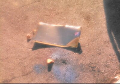

They're flimsy.
It kept developing leaks. I finally ripped it off at the track after oil covered my engine compartment
