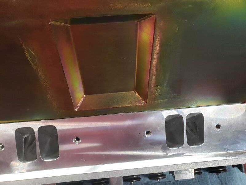

Update I have had the intake manifold milled .060 thousandths from both sides .

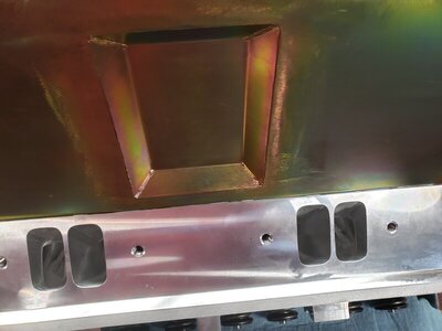

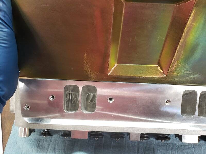

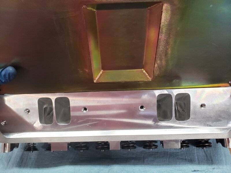

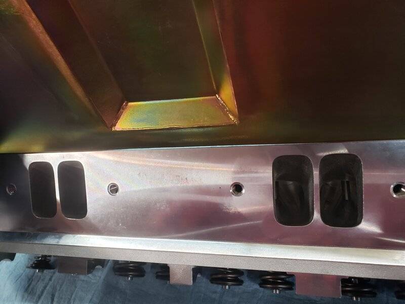

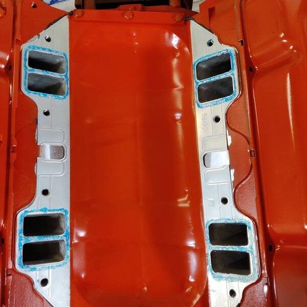

I have used a die grinder and fit the stock valley tin to the ports as close as I could trim without getting into the compression seal of the the gasket. I sealed the ports with Hylomar blue and end rails with permatex black.

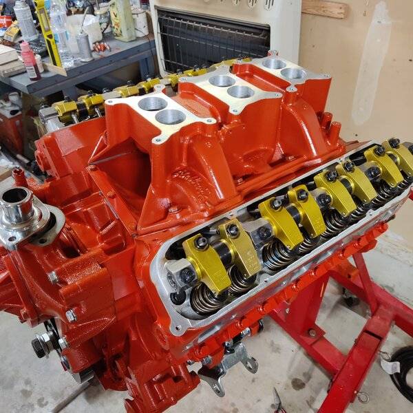

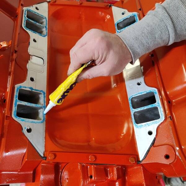

This is what it look like installed.
