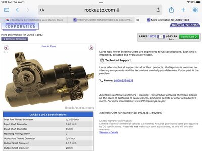

I opened it up and it is similar to my oe roadrunner box, but the inlet and outlet for fluid are in a slightly different spot, and it does not have what I’ll call the “centering valve “ the oe has on top with the pressure and return fittings.

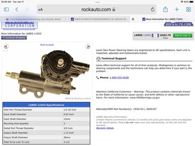

I just added pics from the Rockauto site of the 11033 steering gear. It does not have the valve on top to center the steering wheel. I don’t believe the Borgeson box has the valve, either. Different design from the oe !!
