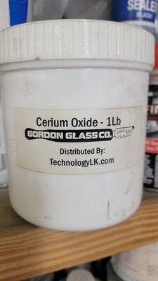

It looks like rust stains. Many products out there for removing rust stains. The first one that comes to mind is CLR and don't use STEEL wool !. you think it doesn't scratch the glass but it does. Try using steel wool on your bathroom mirror. Don't do it! Use fine ALUMINUM WOOL ,if you have to..... It's more difficult to find. But we'll worth it. You can use it on stainless steel trim and chrome bumpers as well. I soak the aluminum wool with dawn dish soap and it works wonders.
If anyone here wants to use ANY grade of steel wool, please use it on a piece of mirror, and then go outside
in the sunlight and see what you've done to the glass! The Cerium oxide will work just fine. Thank You!
