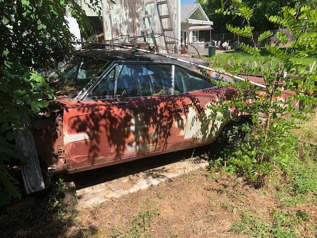

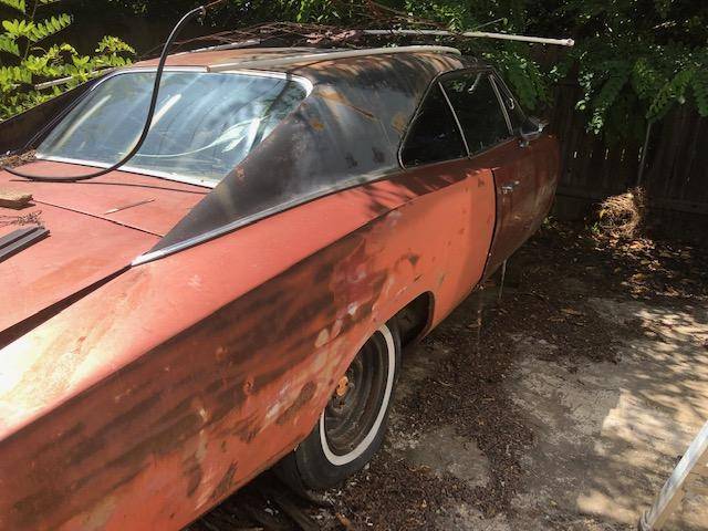

That thing sat under something drippy for a long time?? Like maybe a wet rusty bridge, or a maybe zinc damaged from a rotten roof with a lot of galvanized nails?? Even the roof shows the same streaks. I don't think any birds did that.
Here is how the car sat for at least 15 years:

It may be something acidic has etched the glass. Perhaps bird poo or tree sap. Is were the mark is smooth or rough after a gentle clean? If it can be felt with your fingertip you may not have much luck.

These stains look like oil had dripped on the glass for years but you cannot feel it with a fingernail. It is smooth.

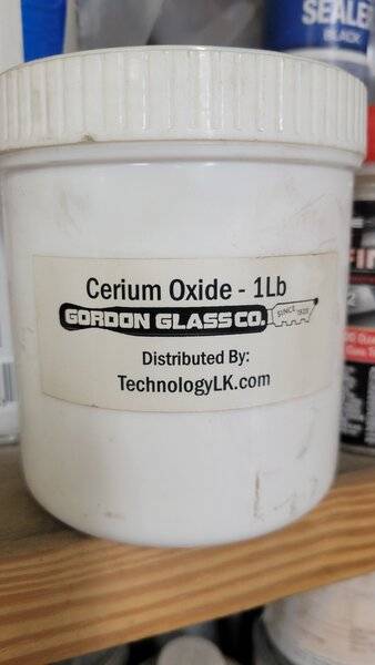

Here's what I've used to get micro scratches out of glass. It should work for those stains.

Go on YouTube and look for some videos. You need to use a buffer that runs at around 2000 rpm
and monitor the heat that you're putting into the glass! You may be able to use a drill, but probably
spinning your wheels. I've fixed scratches in glass by cleaning the scratch with a toothbrush and soap,
then cleaning with Acetone and a toothbrush. Buy a Rainex windshield repair kit and put a small dab of the
resin on the scratch and then apply one of the Mylar strips that comes with the kit. Cure the resin by putting
it in the sun for a few hours, and then remove the mylar and buff the area with Cerium Oxide. Like it
never happened!
I think this is best, although slow and you have to get the glass real clean of anything that the hard fabric rotary buff might pick up and scratch the glass. I’ve also heard ceramic stove top cleaner works well but I didn’t have much luck with it on some hard water spots

Eastwood is one source but I bet you can find it on Amazon too. I’ve used a drill but as noted above a high speed buffer will probably work better. Get the glass clean as possible and if it feels rough it would be a good idea to clay it first. Those hard buffs, if they pick up a piece of grit it will ruin your day.
