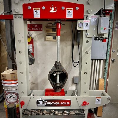

Sorry to have done this to an original axle, but it needed to be done. Just finished removing the axle tubes out of Dana 60. Band saw off the ends to make handling center section easier, plasma cut the plug welds out, pressed them out surprisingly easy (press didn’t even really register any pressure).
The rear end had been modified with traction bar mounts and was bent beyond repair like 1/2” off of centerline into a U, from end to end. Either from damage or excessive heat when welded.
Tried to look for part numbers but it had been ground off when the welding occurred. Only found a date of 1967 and measured 54-1/4” flange to flange.
Ends are still in good shape and will be reusing them. Just ordered some new 3” x 1/4” DOM tubes and should be in shortly.
Final set up will be at E-Body width, 4.10 gears, rebuilt Powr-Loc 35 spline with new clutches, replacement axles from Dr. Diff & green bearings, press in studs for 11” x 2.5” drums.

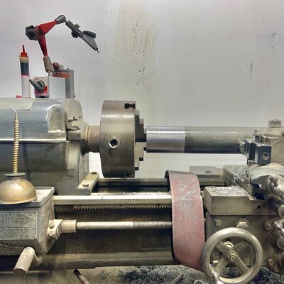

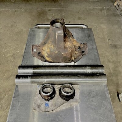

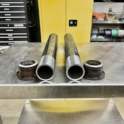

Recieved the DOM tubes this week, turned down the ends for a .007-8” interference press fit, housing ends cleaned up and beveled for welding.

I remember reading in a publication the interference fit was between .005-.010” and around .007” it required roughly 20-30 ton press. The press I am working with is 50 ton.
What do other folks do? How much less?
Yup... I'd be looking for .003-.0035
Rule of thumb, .001 per inch of diameter
Alternate rule of thumb: 0.0005" / 1.000" of diameter for a heavy press fit. For 3.0000" OD DOM TUBING = 0.0015" interference. But different shops/millwrights have their own preferences and opinions and methodology.
