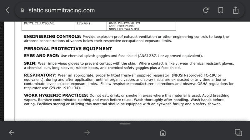

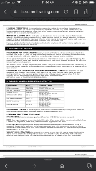

Thanks my msds (Summit Epoxy Primer) indicates for PPE respirator a 29 cfr 1910.134 not sure what that is but add it to all the above ratings and to my point. I understand that I need it for organic vapor but the markings on the filters from different sources and mfg have a mix of ratings as what I listed above. Some say organic vapors some do not even though they have activated charcoal elements.

ok so after re-reading this a few times mfg is calling out a fresh air respirator. Um don’t have that…. The numbers ate referring to use of that system as detailed by OSHA. My point keeps being made. I realize that not a lot of lay people are spraying cars in a non professional shop but in my opinion the mask markings identification and specifications are not very simple as they should be. If I am confused about the filters I have then my guess is many folks are as well…..

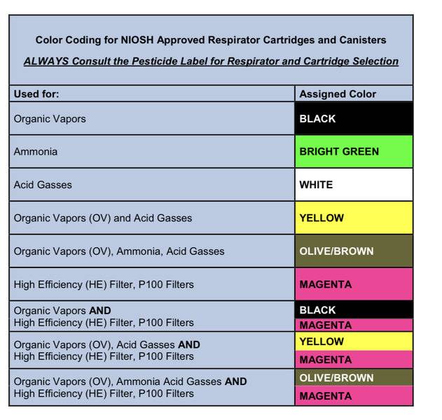

I think this is helpful but not sure who is backing this as a standard.
